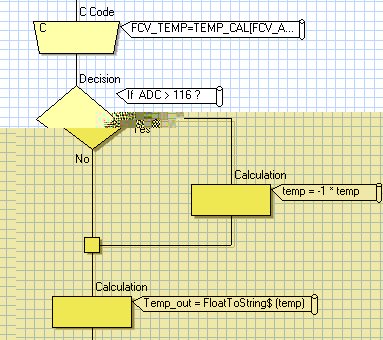

What is very interesting the LUT does not recognise the value of the "-" sign, so had to be think about and got:
sing
sing
Another benefit interesting fact of the readings fell below the 10> 9 Then the display is depicted as 90 in order to solve this problem Temp was transformed into a string.

Sorry..I should notice that your temp variable is byte not int. That's why it can't have -ve value. I have changed that to int...I can't understand why you are using RAM write function and other lcd write options in that way>..Can you please explain that?
