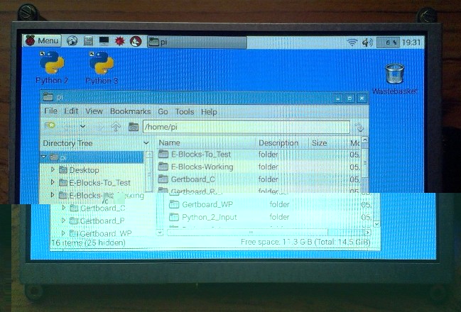

Although the RPi is a great little computer, I've not done as much with it as Id have liked recently. I don't have room for a 2nd monitor and having to keep swapping the monitor cable is a pain, plus it means Im not able to use the main PC at the same time. KVM switch was one option I had considered.
Then I found several suppliers were making small LCD displays to plug onto the GPIO connector, great, but it makes it difficult to use it for hardware experiments.
Then I found this lovely display (Adafruit) for a reasonable cost.
7" with a 800 x 480 resolution
Uses HDMI connection for video and a uUSB Power Connector.
Very impressed with it.
Only minor downside is it does not have a video scaler so the Pi has to be configured to use that specific resolution.
A 5" version is also available
They can also be obtained as a touch screen as well.
As with all Adafruit stuff, a comprehensive data sheet is available.

Post by Steve001 »
very nice , got me thinking of a few uses now :D
Where you get that from john ?

Hi Steve
It came from skpang.com
