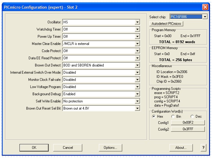

I am only trying to display "Hello Word", and I only get the first 8 digits on the LCD, that is "Hello Wo". I have, HS for the Oscillator, BOD and SBOREN disabled, LVP disabled, and everything else disabled. The crystal is running at 12MHz and runs perfectly.

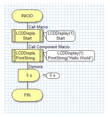

The cristal is a 12MHz cristal, it oscilates perfectly. atached you will find the configuration, and the FlowCode.
It does not respond to moving the cursor to the second 8 digits, it does nothing.
I must point out, that I custom wire the port "B", as you can see in the code, could that be the problem? I did this, for I have done it for AVR's without any problem.

- This is the FlowCode
- FlowCode2.jpg (100.47 KiB) Viewed 12727 times
- This is the micro configuration
- FlowCode1.jpg (51.97 KiB) Viewed 12727 times

Trate tabla enamuls, una cosa que me di cuenta es en el código C que parece poner el cursor a partir de las 8 de manera comenzará en la mitad posterior deEl lcd
después del inicio lcd macro agregar una macro cursor con 0 0 en el mismo
esto obligará a la pantalla para comenzar en la posición 0
háganos saber cómo le va

Try enamuls chart, one thing i noticed is in the C code it seems to set the cursor starting at 8 so will start in the later half ofthe lcd
after the start lcd macro add a cursor macro with 0 0 in it
this will force the display to start at position 0
let us know how you get on
Dazz

I have found a solution for you. Although I was thinking Stribor was wrong..But he is right if my guess is right..The LCD you have is of 16*1 LCD type 1 which has RAM address from 0x00 to 0x07 (in first 8 charecters) and 0x40 to 0x47 (in next 8 characters). So using Flowcode and single line LCD it will not work..In the code I have changed that to LCD (16*2) to adjust address location..so please try that one and let us know.
Edit: Added FCV4 version for you...
