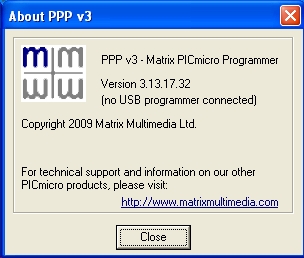

Hi Ben,
I downloaded the latest ppp software and installed it to my tools folder, the version is: 3.9.12.26

Hi Stuart
Just checked on my system
Help / About shows I'm running PPP 3.14.18.33
That was installed as part of flowcode 5.4, i did not install it as a seperate program.
Just checked and can confirm the version on MM website is what you donwloaded 3.9.12.26
As Ben says if it will program other devices its unlikely to be the programmer.
Think you'll have to wait till the new PICs arrive and see what happens.

Hi John,
Does that mean that the version that I have downloaded is older than the one shipped with my Flowcode 5 ?
If that is the case then maybe I should reinstall Flowcode and all of the updated files that I have added.

I have just uninstalled Flowcode and reinstalled it, I remember now why I downloaded the latest copy of ppp, It is because when I try to run ppp from the tools directory I get an error message, I am enclosing a pic of this, I am also enclosing a pic of my ppp version.

Hi Enamul
There is no instalation file with your archive file so I take it I can just replace ppp folders in the tools directory.
I have done this but I still get the config error message.
Surely it should not do this with a fresh install from my flowcode disk anyway.
