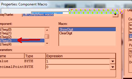

Now I have hit a glitch using the 7 Segment Displays. I'm using them as a Display to simulate my end result to control the segments in a display.
In this example I have two displays with labels LedSeg4 & LegSeg5. Seg 4 I have set the common to Port A 1 and Seg 3 to common Port A 4.
Now in my program I send display to the SEG4 to count to 9 and step 10 to "0" call a routine to advance Seg 3 to 1 giving me "10" and then go back to Seg 4 and step thur to 9 and the back to Seg 3 to "2" with a max score of "29"
Oddly once Seg 4 display 1 the mess begins.
I would think if I send the Display to led Segment 3 why is Segment 4 not staying as 0
Maybe I need to address the Port A but not sure how. When I set Port A pin 1 low the display blanks so that wont work.
Your help would be appreciated.

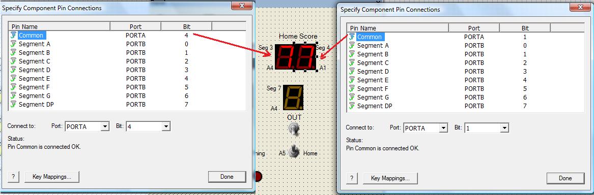

Thank you for adding in the Interrupt to control the macro. I thought having so many calls would mess it up and now I see how to address the mess.
Can I ask how Flowcode displays the 7 Segment. I thought I could place the common Anode lead to one PORT A where in the real it would be GRD or +5 depending.
In Flowcode if I have the "Display" selected as LedSeg 5 I would expect that ONLY LedSeg 5 would change ??

I have included a PDF word document to help wrap my thoughts on how Flowcode displays the segments. Had to make it PDF to upload.
No it will not work like that.
Lets take a common anode display.
Since all the cathodes of each display are connected together, e.g segment a of Display 1 is connected to a of Display 2 which is connected to a of Display 3 etc, then if you put all the anodes together all the three displays will only show the same value!
So what you need to do is only make one anode at a time positive, then when say all the the 3 displays have the following low:
a, b, c,d,e,f then only the display with anode high will show the number 0.The other two displays will have their anodes at a low, so there is nothing on there displays.
so to get all the displays look like there are showing the correct digit, each 7seg display anode has to be quickly go high, so number is shown then go low, so number goes out, it this is done quick enough then due to persistence of vision, each display will look like its permanently lit with a solid number.
Hope I have explained it ok.
Edit Just looked at PDF you have posted and your 7seg are connected up as common cathode, not common anode. So when each individual cathode is low, then display is enabled. When anode (a to g) goes high then corresponding segment will light.
Since you have stated about common anode then I'm not sure which one is correct.
Have you got a data sheet or part number for your 7seg display?

I tried messing with the On off states of the Anodes to only turn on the PortA bit say for Ball segment and allow it to read the Port B common bits. Now when I turn off the Port A bit I loose the Ball display digit.
When I go ahead with sending the Port B result to my Electrochemical Display segments they work exactly like turning on the Port A bit and reading the Port B and then turn off the Port A. The Electrochemical Display use magnets to maintain the vane displays.
When I set the Anode ( Port A ) to a low the display digit goes out and there is nothing to redisplay ?
Example if I have segment BALL display 1 and now Segment Strike get say 2 if I turn off Ball Anode I loose the display 1.
Unless I'm missing something.
