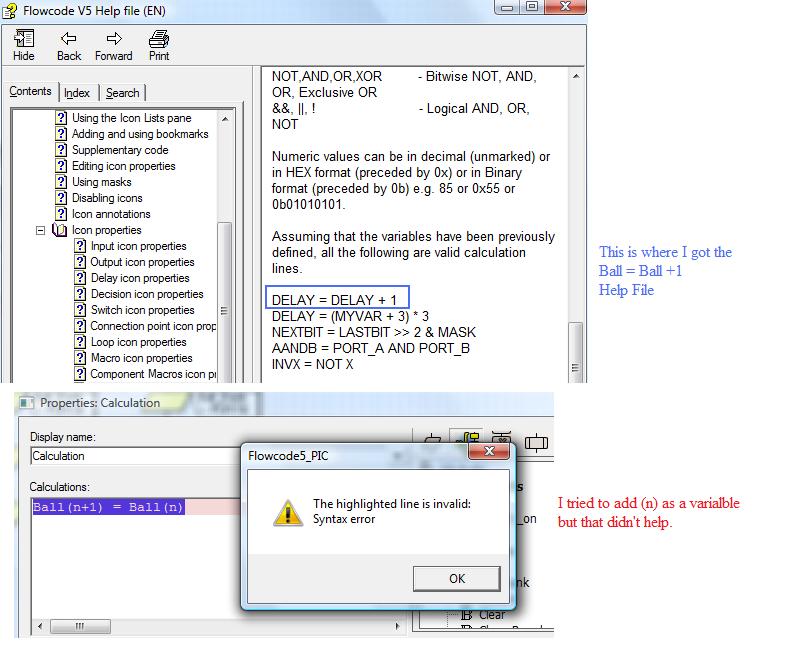

Yes you are 100% right I was not sure how variables worked and could not find any course material so I used what I thought was logic that if you start with Ball = 0 and then Ball + 1 = Ball is like saying starting with 0 in Ball and adding 1 would place 2 in the ball variable.
Ball(n+1) = Ball(n) - So in this formula would be placed in the Ball Macro ?
Would I then make a Variable setting for N = 0 ?
This error message is odd because the Value for Strike & Out don't appear to bother the program this is the odd thing I can't grasp.

Well I thought I would try the Ball = statement with your Ball(n+1) = Ball(n)
Now I added it to the Marco Ball and it does not like it.
Did I enter the info in the wrong place ?

Hi. Apologies, I am not being clear. Your increment is fine - the 'Ball = Ball + 1' is valid code and increments Ball by 1. The 'Ball = Ball' does nothing - it increments Ball by zero.
