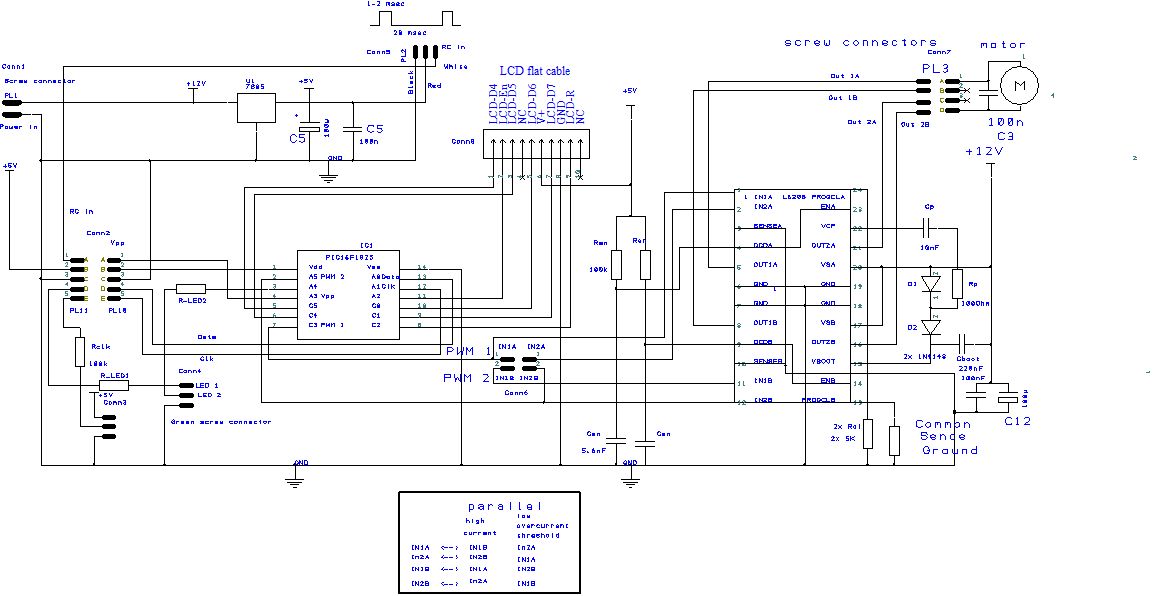

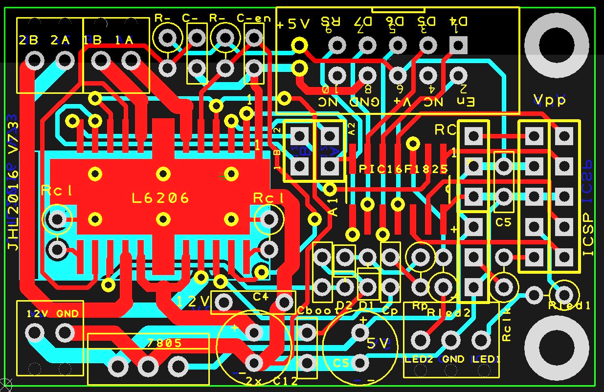

Please find an update of the RC speed control of DC motors.
After some practice in my garden gauge I train (45 mm) I found that the Flowcode is working correctly, but the speed control bridge used ADP3624 will start oscillating at higher currents. I tried a lot to improve it, but without success.
That made me to look for a better one, which I find here in Matrix house with the EB094 block. Here is used the L6206 bridge, which even have 2 outputs for 2 DC motors. The only thing I did is to produce a small PCB board which combines both the microchip and the bridge. I extended the board with a LCD connector (2x5 pins) which can easily be connected to the Matrix LCD board by means of flatcable connectors. Additional is the V+ (5Volt) power available in the connector.
In the meanwhile the Flowcode has been improved and extended with the LCD output. The LCD output will be used only for test reasons, because it delays the response to RC-time changes.
Please find the last Flowcode, the electric scheme and the PCB layout. The PCB format is 32x50 mm. Even as amateur it is possible to solder the SMD parts. Still interested? Contact me and I can be delivered the PCB board for low cost .
Kind regards
Jan Lichtenbelt
V73_16F1825_14p.fcfx
(170.48 KiB) Downloaded 1316 times
Click on scheme for enlargement
(283.38 KiB) Downloaded 10289 times
