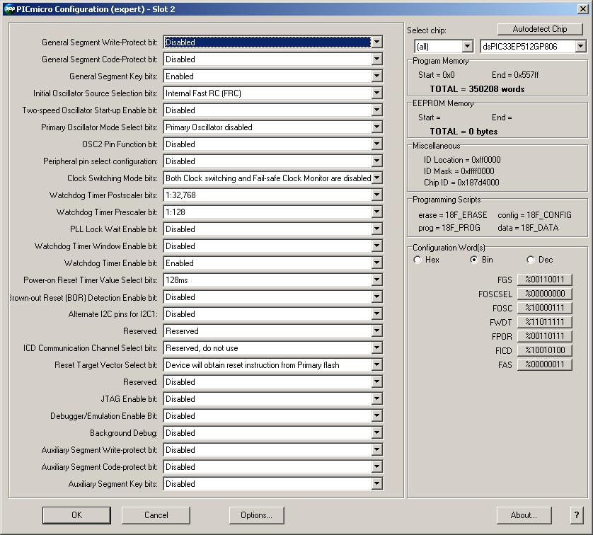

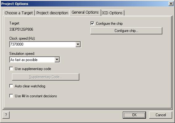

I have tried everything and I'm a bit desperate now... Flowcode 5.5.2.1 Professional.
I have a simple circuit: dsPIC33EP512GP806 (have tried on different boards as well), nothing connected to it, very clean 3.3V (10uV ripple), no external XTAL, and for testing I'm using the internal Fast RC oscillator to get the dsPIC started at least.
The simplest for example to enable port D.L(all bits), it just doesn't work at all. I get no signal out of the pins...
I am able to program/verify the device successfully through both Flowcode and through MPLAB X too. I'm using my PicKit3 which I currently use to program my dsPIC30F5013 devices...
I have tried all settings in the Project Options to no avail. Latest settings I have tried with are shown below, I have however tried with many different clock speeds and any setting possible. I have even tried the config bits by following eahc of the entries in the Data Sheet (DEVICE CONFIGURATION REGISTER MAP), still no luck :-( Very frustrating!
Thanks for your help!
PS: I use both dsPIC30 and dsPIC33 micros and although the dsPIC30 took me some time to get it to start, it worked in the end... it works fine with internal Fast RC no PLL.
Project Options settings not working
(126.69 KiB) Downloaded 509 times
Configure Chip settings not working

Ronald,
I would:
1) Disable the watchdog.
2) set ICD Communication channel to another value. "Reserved, do not use" feels like it should be avoided to me...
3) Set "General Segment Key Bits" to Disabled.
Good luck!
Jac
― C.S. Lewis

First to thank Jac for his amazing help with my MCLR pin (stupid one, this one was yesterday = got fixed). But then again today he gave a great clue: go into MPLAB X and instead of programming the micro only, make it run in Debug mode (PICKit3 seems to support this in MPLAB X).
Anyway, I did so and the program ran fine!!!!!
But then after power was turned off and then back on (3.3V), the micro would not start at all. Same situation as before (head scratching).
So I have figured out that in order to make the micro start correctly, Debugger/Emulation Enabler Bit must be set to Yes in Flowcode.
Anyway, this smells like a small bug to me, will investigate further, but at least I can use the micro now.
I can only recommend Jac here if anyone wants professional Flowcode services (he's programmed some neat stuff for me in the past) he's great!
Thanks guys, hope this entry helps anyone else...
Ronald
Set to Enabled made the micro work again
