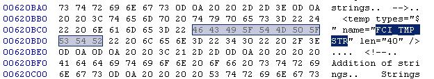

OK, seem to have found something around FCI_TMP_STR, but it's in the DLLs, nothing I can edit around Flowcode... :-(

OK, issue fixed, a bit dodgy fix, but works fine!
I have edited with an Hex Editor the file Flowcode5_PIC_16bit.exe under C:\Program Files (x86)\Flowcode(dsPIC)\v5
I have found the 2x string FCI_TMP_STR ocurrences and changed it to len40 instead of len20. Saved the EXE and voilá it works now!!!!
Guys, would be nice to get this fixed, unless intended...
