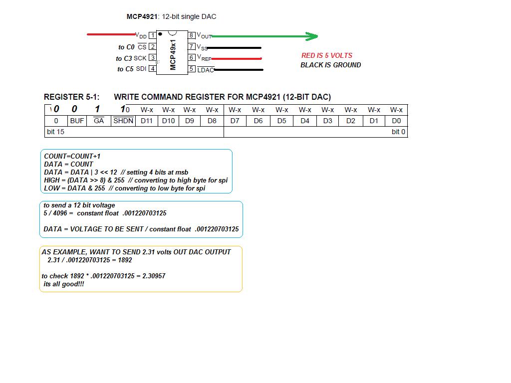

i'm using a microchip mcp4921, these chips are easy to use with the spi protocol,
since this is a 12bit dac, you can get 4096 different values, using a 5v referance
5volts/4096 = .001220703125 mv_per_step
to figure out which number to send to the spi port for desired output voltage is easy to
chip_send_number = desired_voltage / mv_per_step
there is a couple things left to do, you have to set bits 12 and 13 in the spi 16 bit message to do this
chip_send_number=chip_send_number | 3 << 12
then convert the 16 bit variable into two 8 bit variables to send
high=(chip_send_number>>8) & 255
low=chip_send_number & 255
pull chip select pin low, send high variable char, send low variable char set chip select pin hit
this chips is very quick to make a triangle waveform by looping 0-4095-0
SPI DAC TEST.fcf
(11 KiB) Downloaded 928 times
in this flowchart i created a quick draw up as an example of manually picking out a voltage, using rc5 and a remote as a keypad, you can type in a voltage value then press the blue button to set it, top lcd line shows the commanded voltage, bottom line shows the commanded 12bit value
spi remote commanding dac.fcf
(18.16 KiB) Downloaded 883 times
here is a cheetsheet for hook up and operation
(74.72 KiB) Downloaded 4055 times
