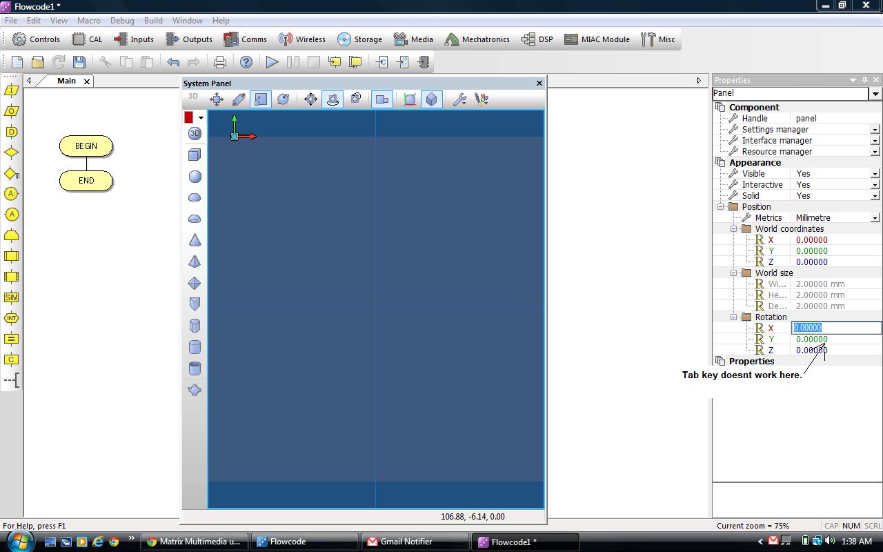

Tabs don't work they way they are used to rapidly develop a flowchart,
In menus i cannot jump between one another by using tab / shift+tab key of my keyboard. Have a look at the picture. Too bad Rs232, i2c components are entirely changed. They were much cool & simpler to debug and understand about how they work in previous version.
No doubt that added components are truly exciting but as far as i remember target of flow code was for simplicity and that is deviated a little bit. I hope it doesn't drift beyond. Till v5.5 MM is moving with excellence. But in V6 mmmmm. Frankly it looks like MM is trying to merge 3ds Max with fc. Not a good idea. which will definitely disturb the simplicity and surely the prime target of FC.
What happened to you guys exactly? Is MM "Team" got bored of interface or users?

Re: interface
ok but that looks awful. medelec. I hope MM give respect to its user input.
i am just giving my honest opinion.
- (106.73 KiB) Downloaded 4602 times
