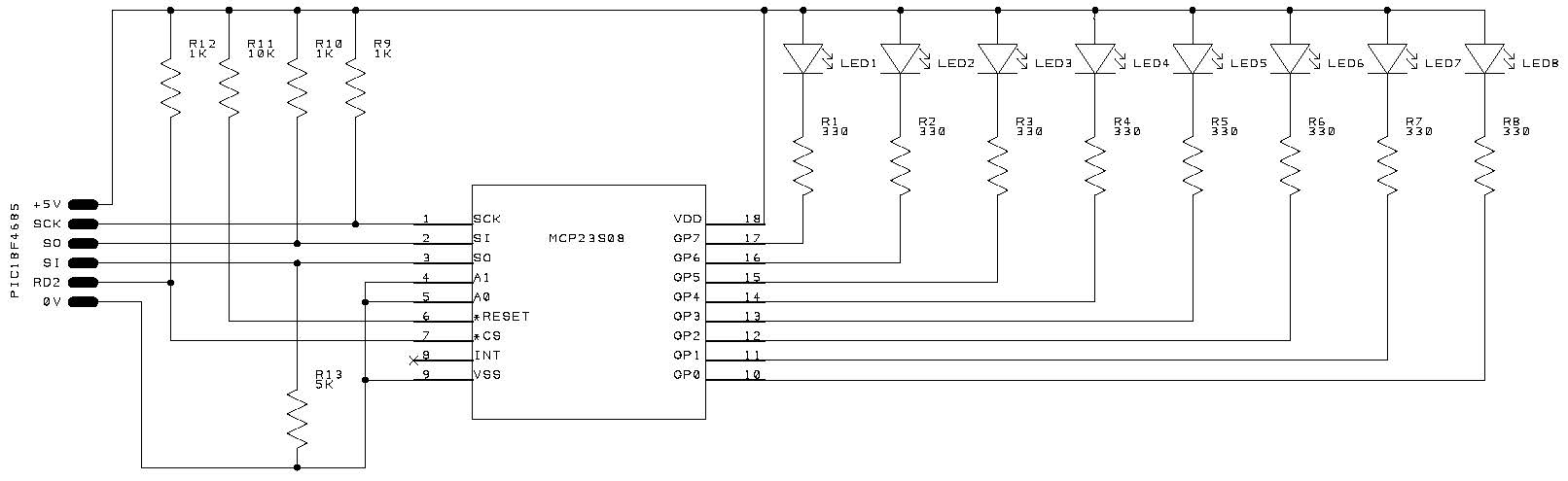

I have the PIC18F4685 connected to the following MCP23S08 circuit (found in an application note somewhere)

The LED flashes but no matter what value I send to the port of the MCP23S08 the voltage on the port pins never changes.
The CS goes up and down and there is activity on the SI & SO pins (though I have only seen this using a digital multimeter not a scope (I don't have one).
