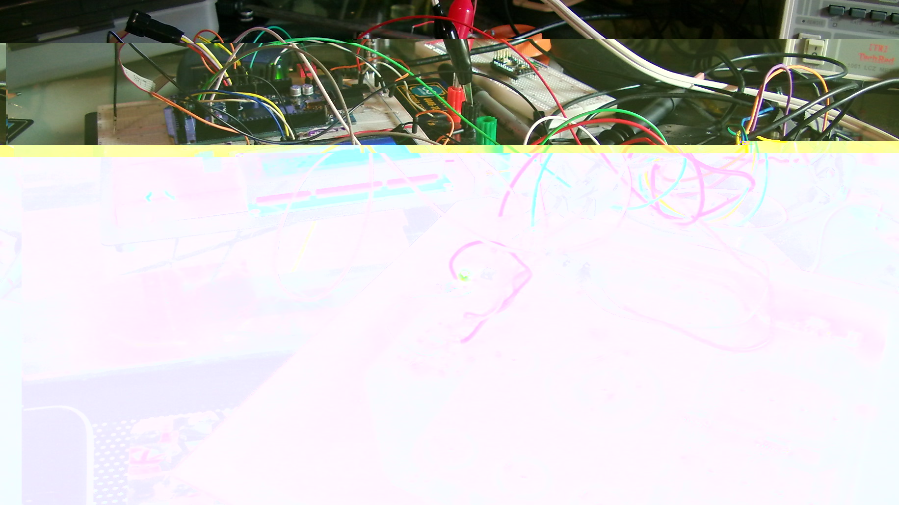

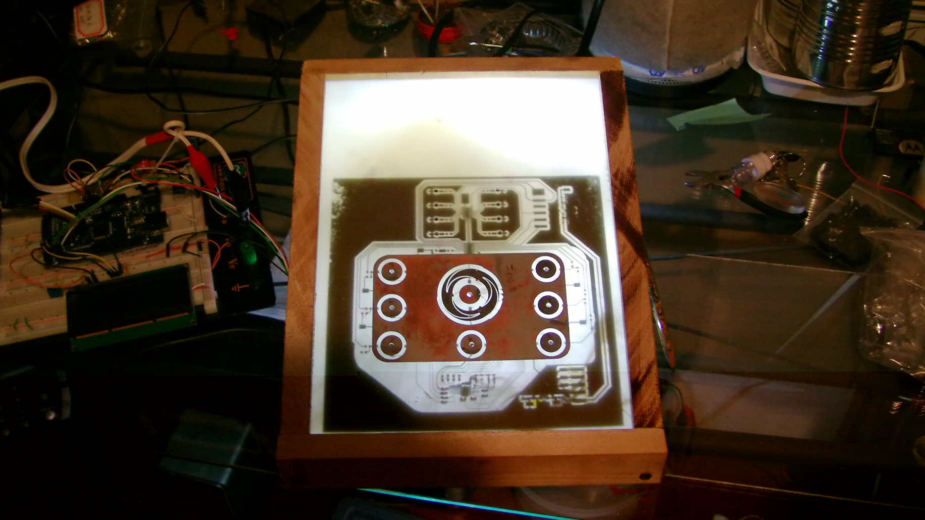

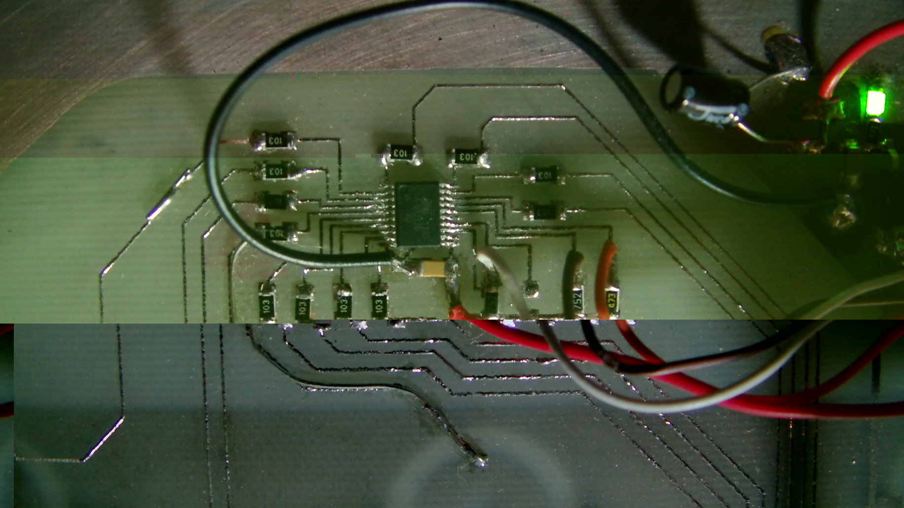

I have also attached some pictures of the first board I made for testing this chip..
this panel has 8 push buttons, 1 wheel, and a guard channel..
I created a code for this panel to allow me to see if it functioned properly and everything worked as it should..
