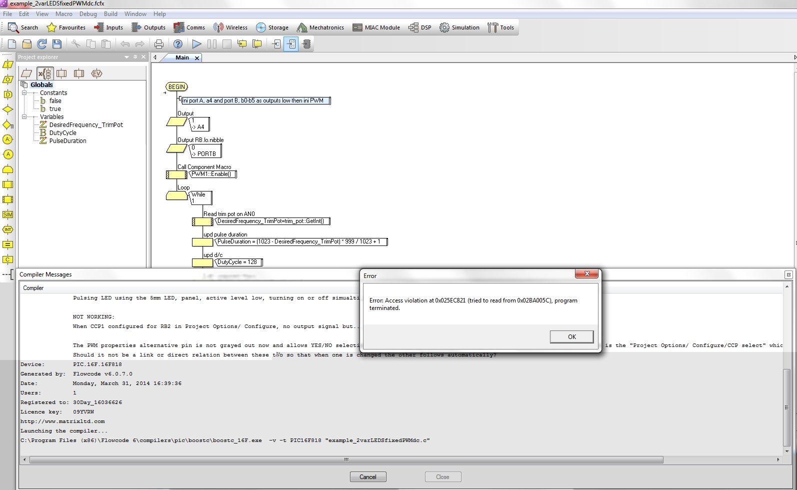

I did some minor changes to a simple program used to help me learn FC, its abilities and limitations and run into this error. Restarting FC does not help, keeps reporting same error. I am attaching my file and a JPG
Currently running FC 6.0.7.
JPG of FC with err
(191.28 KiB) Downloaded 491 times

Restarting FC does not fix, restarting W7 does... could it be that some of the modules load up and get corrupted? Wonder which one is used by the compile to hex?
Running FC 6.0.7 on W7

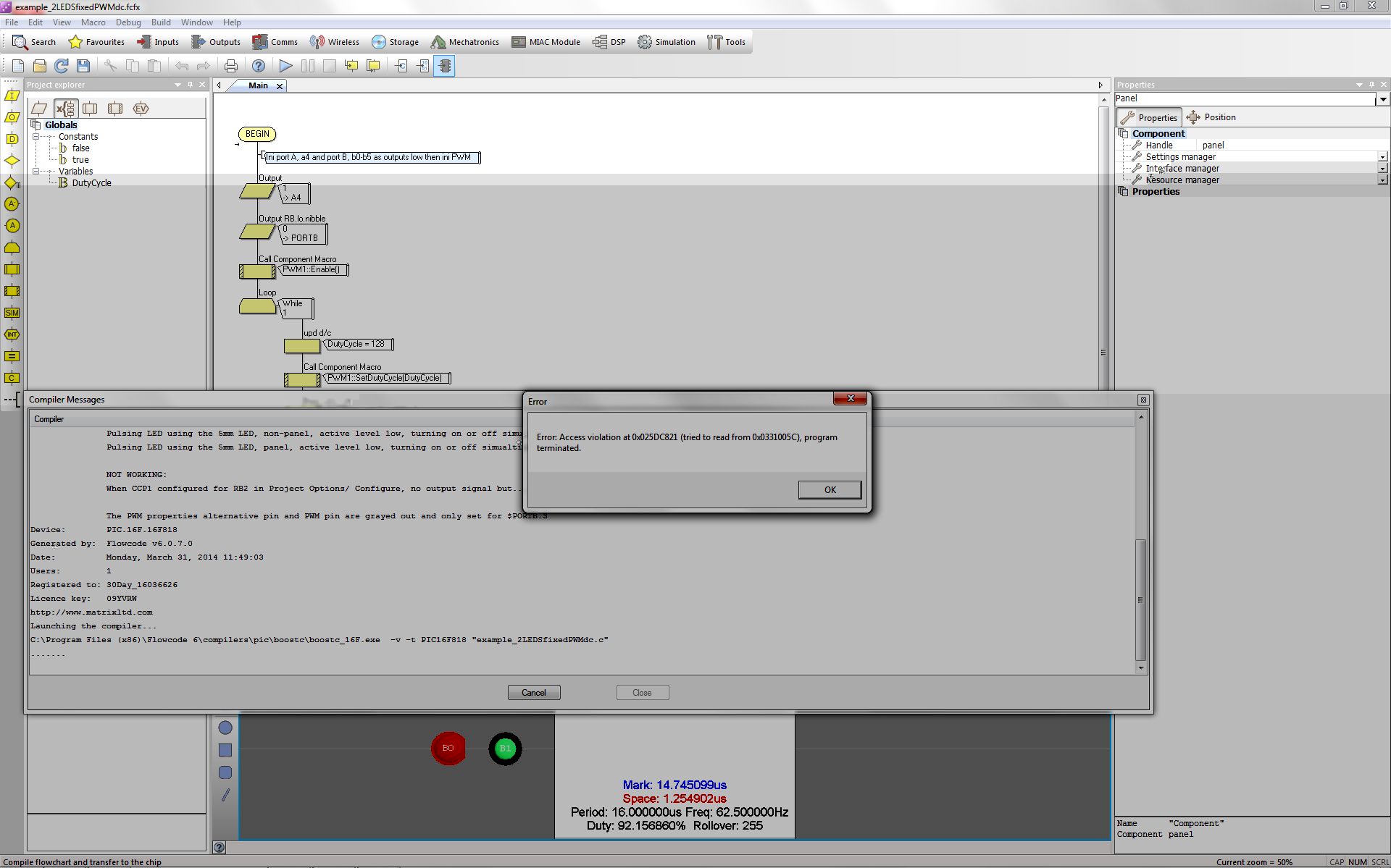

Here's another JPG
(149.93 KiB) Downloaded 475 times

I noticed now that every time I wake up the PC after it goes to sleep (due to inactivity) the boostc_16F.exe generates this access violation error. The only way to resolve this is to restart the PC.
Hope this helps you identify and fix this problem. If you need additional information from this end please ask.
