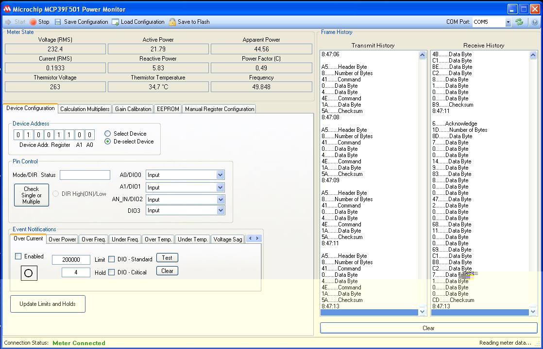

- this is the screen microchip software
- MCP35f501_caprtura_1.JPG (147.77 KiB) Viewed 5531 times

I'm trying to capture the frame the software returns IC microchip.
This is the program I'm doing wrong?
thanks
