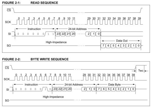

Could you please have a look, and tell me if this is usable for FC5 and my eeprom (25AA1024, programming sequence attached).
Especially what about #include "eeprom.h" . Is this already included or do I have to add something to my flowcode project (...supplemantary code?).

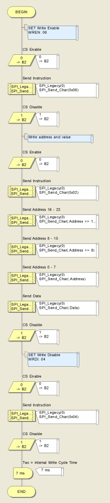

Hi to all
Now it's working!!
This is how it could be done:
1. connect the 'DAC enable Pin' and the 'NVM enable Pin' of the SPI component in the panel to the same pin your CS/SS pin is located ( ATMEGA328: Pin14 : SS /PB29)
2. don't forget to initialize the SPI at the beginning of your code -> Component macro: SPI_Init() (...that was my biggest fault)
3. for writing to the EEPROM you always first need to set the write enable latch with a special command (in this case: 6)
4. now write your address and data
5. after this you should reset the write enable latch (my command: 4)
6. at last you need to add a delay between two write cycles depending aon your EEPROM (in my case the Twc = Internal Write Cycle Time >= 6ms )
Attached you'll see the complete procedure.
Hope this will save time to all others...
Best regards,
Niro
