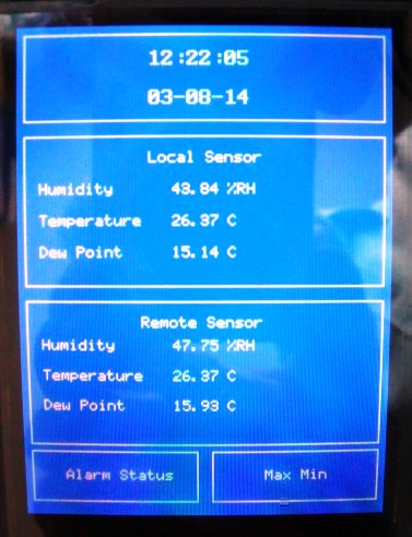

This project is a 2 channel environmental monitor. It was spawned when I obtained the humidity sensor.
I have already used the LM35 type temperature sensors in previous projects
It can measure temperature and humidity.
Dew Point is also shown as a calculated value.
It also incorporates a real time clock and touch screen display.

Sensors:
Channel 1 (Local) - Connected to Port E
ADC5 = Humidity .
This is measured using a LinPicco A05 Basic sensor.
This has a DC output of 0 V to 5 V for 0%RH to 100%RH.
The output is measured from an ADC input as a voltage (Float) and then multiplied by 20 to give a direct reading in %RH
ADC6 = Temperature.
This is measured using a LM35CZ (3-pin) device.
This also has a DC output of 10mV/°C.
This can also be easily read directly by the ADC input.
It will be noticed the local sensors are inside a plastic tube.
While it will be appreciated this will have an effect on the accuracy of the readings, it is to protect the delicate humidity sensor during development of the system.
Channel 2 (Remote) - Connected to Port A
ADC0 = Humidity
ADC1 = Temperature
Currently Channel 2 is simulated.
A pair of trimmer potentiometers wired as potential dividers are used to generate the signal voltages, as I only have 1 humidity sensor (used on the local channel.)
This also using this makes testing easier as I can set any humidity or temperature over the full working range.
I can also swap Local and remote by swapping the 2 D-plugs round
The values displayed on the main screen are rounded to 2dp by means of a C-Box in the flowchart.
Note: C- Box’s do not simulate.
Dew Point:
Dewpoint is the temperature at which condensation will form.
Its accurate calculation is quite complex and not necessary for this project.
A simplified version of the calculation is as follows.
Temp_DP = Temp –( (100 – Relative Humidity)/5)

Alarm Connections:
Local Sensor
B0-Orange Humidity Low
B1-Red Humidity High
B2-Orange Temp Low
B3-Red Temp High
C0-Green Humidity Normal
C1-Green Temp Normal
Remote Sensor
B4-Orange Humidity Low
B5-Red Humidity High
B6-Orange Temp Low
B7-Red Temp High
C6-Green Humidity Normal
C7-Green Temp Normal
To save on memory, the values are converted to integers before being tested.
It was not considered necessary to have the precision of a FP variable for this.
This also allows a simple Yes/No decision box to be used rather that the more complex test needed with a floating point number.
While these are displayed using LED’s they can also been seen on the display by means of the first soft key on the touch screen display.
Max - Min Display:
The same integer variables used in the high / low alarm are used for Max Min testing.
Again, it was not considered necessary to have the precision of a FP variable for this.
The current value is compared with the last maximum variable and if greater it is stored as the new value, if not it is discarded.
The same idea is used for the minimum values.
These can be seen by use of the second soft key on the touch screen display.
Max – Min values are currently lost when power is removed.
The Max values are initialised to 0 and Min values initialised to 100 when the program is first started or reset is pressed.
This allows them to be set to the current ambient the first time the sensor is read, and then they will change as the readings increase or decrease.
