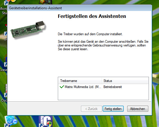

I received my ECIO today and I am not able to get the drivers to run .

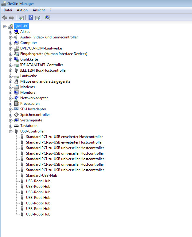

I installed the driver for the 32bit machines as per manual windows show that the driver were installed and then I go to device manager as per manual however the device does not show up under the
universal serial bus device therefore I can not run the instillation as mentioned in the manual

This following info is for the ECIO40P.
It is likely the ECIO driver is correctly installed and that the ECIO has left it's re-programming bootloader mode. If you press reset on the ECIO while it is powered then it should appear in the device manager for approx 5 seconds before disappearing again. The LED on the ECIO will be flashing while in bootloader mode.

The 40P16 is a HID based device meaning it does not need a USB driver and will appear in the HID section of device manager while the bootloader is active. Again the bootloader will only fire up for approx 5 seconds on first power up or reset.

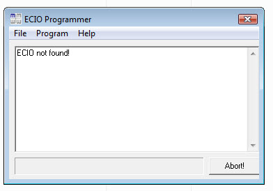

If I open the ECIO programming tool and then reset the device should it connect to the device as this is not happening at all ??
both the ECIO programmer and FC does not find the device,I do press the Reset button at this point

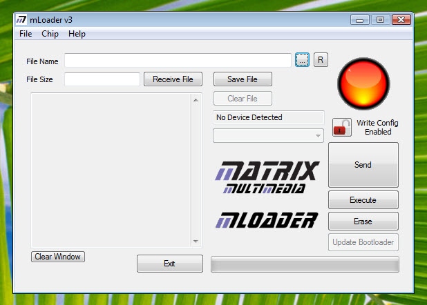

The ECIO40P16 only works with the mLoader software.
If you run the mLoader tool then it should automatically detect when you connect the ECIO40P16. Again the flashing LED indicates when the USB bootloader is active and having the mLoader tool open should keep the device in bootloader mode.

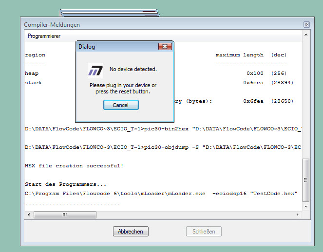

If you compile from Flowcode then when the pop up message appears try pressing the reset button on the ECIO40P16 device and this should allow programming to start.

In flow Code I compiled and when the popup come up I press the reset nothing happens no led what so ever
M loader the same thing I also try to reset the ECIO no led at all

as Ben mentioned this ECIO does not need any drivers it is an HID device and should install automatically ,you can open M-loader and it should show if it is seeing the ECIO40P16 if not then you have to make sure that the boot loader is running on the board with me it was a problem with the boot loader
When you power up the board does the Led flash ?
