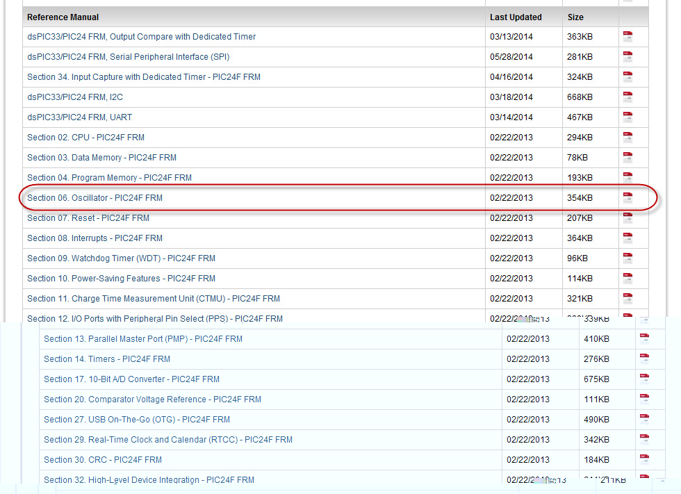

cobra1 wrote:I have an LED blinking on and off at 1 second intervals, but to get the correct timing i have to set the frequency in general options to 21Mhz
This is not what i expected.
It is because you have to set the Clock Divisor .Read the Reference manual for the oscillator which explain how the oscillator function and which registers contains which bits with their functionality
http://www.microchip.com/wwwproducts/De ... e=en531081
Hope it helps

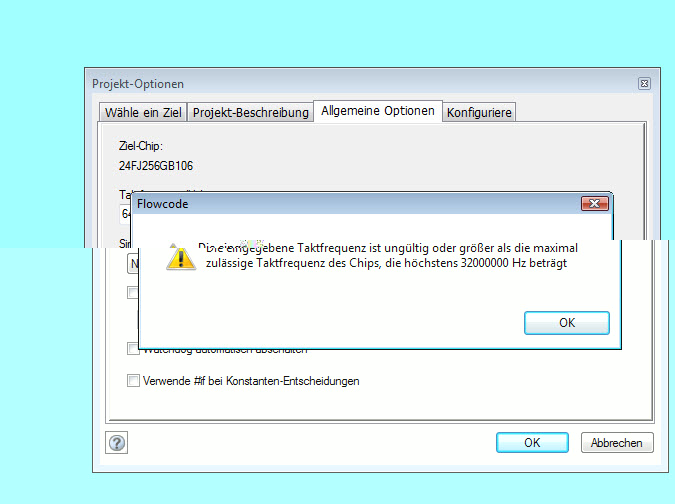

I would advise you to use a 8MHZ Crystal with PLL enabled which give you the max allowed clock speed of 32MHZ,I wanted to do the configuration for you with the 16MHZ x PLL which equal 64MHZ and then set the Divisor bits however FC does not allow to enter a higher clock frequency that 32MHZ so I guess the 16MHZ Crystal with FC is not a good choice for an crystal.

QMESAR wrote:however FC does not allow to enter a higher clock frequency that 32MHZ so I guess the 16MHZ Crystal with FC is not a good choice for an crystal.
I'm using frequencies of 120Mhz for certain controllers with Flowcode. Just enter the value manually and all should be fine. Flowcode does not allow entering values above the maximum the chip can run at, so if manually entering the value fails there might be an issue with the chip definition.
yes I agree I am using 140Mhz on a dsPIC33EP but for a PIC24F FC allow me only to enter 32MHZ the reason I suggested to use the 8MHZ Crystal that would allow the max 32MHZ(16MIPS) for an 24F and and the the users timing issue will be solved n FC is happy and the user is happy too :D
Then from the reference manual for 24F the max is 32MHZ again 16MHZ Clock and PLL makes no sense to use for PIC24F
To cobra1 attached a tutorial how to configure PIC24F clock speeds and settings
Hope it helps you
CLOCK.pdf
Tutorial how to set the clock on 24F
(194.01 KiB) Downloaded 327 times

Re: PIC24FJ256GB106 Oscillator config
Regarding the none available 64MHz oscillator speed option, the datasheet states this.
Up to 16 MIPS Operation at 32 MHz
But then in the electrical characteristics section there is this comment which makes me wonder.
For frequencies between 16 MHz and 32 MHz, FMAX = (64 MHz/V) * (VDDCORE – 2V) + 16 MHz.
A 16MHz crystal should be ok just add this to the start of your program in a C icon and set the project clock speed to 32000000.
CLKDIV = CLKDIV | 0x40;
