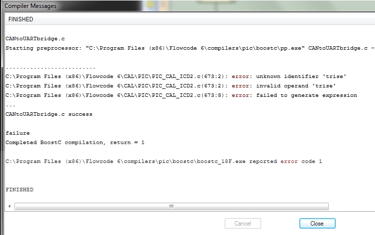

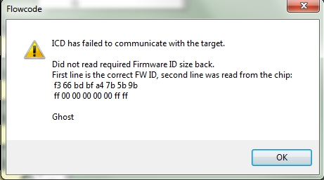

I run into compiling errors when trying to enable Ghost in my project. I am attaching JPGs and project file to document.
This project tries to interface a Sendyne high precision current sensor to CAN bus. With little effort it may become a UART to CAN bridge.

Ghost not working with PIC18F26K80

Re: Ghost not working with PIC18F26K80
Thanks for letting us know of the issue,
I have fixed the config problem in all the K80 definition files. Here is the 26K80 update for you and needs to be placed here: "C:\Program Files (x86)\Flowcode 6\FCD\PIC".
I have also hopefully fixed the ICD compile error you are receiving. The following files need to be placed here: "C:\Program Files (x86)\Flowcode 6\CAL\PIC"
Let me know how you get on.
