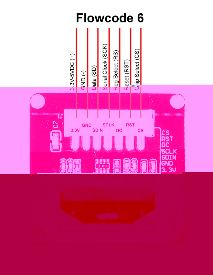

First problem noticed was the wiring. How do I connect this display?
On their website there is a zip file named “1.30_OLED.zip” After download and unzip we can see inside a “Manual” as text document where we can read the connections. I double checked that with the Arduino Mega photos.

I realized the 3.3V is the most left one near the capacitor C7. Also I made some tests with different pins position and different gLCD based on SSD1306, which is the closest component to SH1106.
Finally I got it working using the component “gLCD_SSD1306_buffered”.
https://drive.google.com/open?id=0BwXmK ... authuser=0
The wiring is as follows:

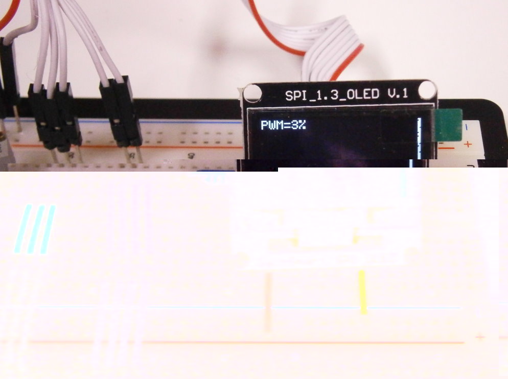

SainSmart OLED 1.3 SPI 132x64_1
(168.32 KiB) Downloaded 2532 times
SainSmart OLED 1.3 SPI 132x64_2
(128.63 KiB) Downloaded 2532 times
A video about it:
Next question from forum ( http://www.matrixtsl.com/mmforums/viewt ... 56&t=16374 ) points to an important problem of the display: it is 132x64 and not 128x64.
That can be seen in my video and my pictures as white vertical lines on the right side of the display.
QUESTION1: - What can be done to remove the vertical white lines?
I tried the settings of “gLCD_SSD1306_buffered” to set 132x64 or even 130x64. The white vertical lines disappear but then the printed characters are garbage.
If I print alphanumeric characters starting with position (x,y)=(0,0) then some parts of them are not printed. I have to start at (x,y)=(2,0).
These results confirm that is 132x64 and not 128x64.

2) Adafruit has a lot of info on their website about connection/wiring. With the same code inside the PIC18F4550 as for SainSmart SPI, I just made the proper wiring connections and the OLED Adafruit worked from first time without problems.
I wanted to try also I2C with the OLED Adafruit. I soldered the jumpers on the back side, replaced the component “gLCD_SSD1306_buffered” with “gLCD_SSD1306_I2C” in Flowcode, but the OLED did not work. It is black. I tried with and without pull-up resistors on the SDA and SCL lines.
Looking at the Adafruit website recommended connections, I notice that is also the Reset(RST) pin recommended to be connected to Arduino.
But in my case, using PIC microcontroller, inside the Flowcode 6, are only 2 lines to be configured and not the third one Reset (RST).
QUESTION3: - how do we make the component “gLCD_SSD1306_I2C” working with PIC microcontroller without using the Reset (RST) ) pin recommended to be connected in Arduino case? Or where should be connected the RST?
