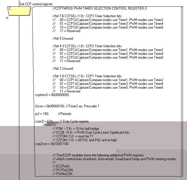

I'm making a macro to run PWM Half-Bridge and you can adjust the period, dutycycle and deadband.
I would like to make a new PWM component or modify the current Matrix property but do not have the C code to make it as medelec35 said.
I think it is important as it will convert more functional component and for example in my case I can not do otherwise.
In the capture shown as configure the PWM to operate.

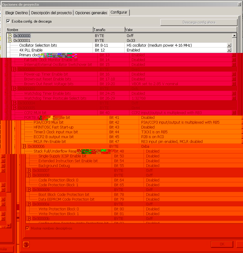

I think I have something misconfigured in CCP2 options because I do not get the two outputs of Half-bridge PWM.
Thank you.
I found the fault in the hardware, not the micro settings.
