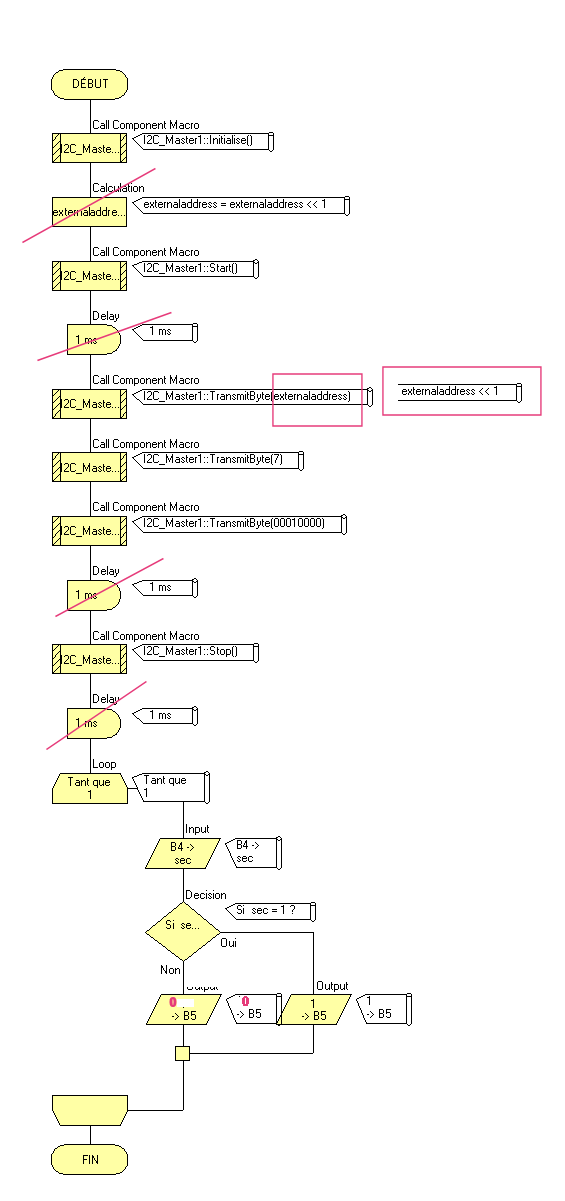

I been trying a I2C communication program to set and read the registers of a DS1307 time keeper IC. I'm starting with a simple program to write and set the register 07h, to enable the square wave and set it to 1Hz. Then the program uses this signal to set B5 HI which will lit the LED of the arduino nano on channel 13 (B5) to prove that setting is done. I did read the SPI and I2C Simplified communications blog and I did it in the same format, but I did not have a success with it.I have to mention that the component I2C calls for pins C4 and C3 for SDA and SCL respectively but when I check in the Chip view the SCL pin is C5 (in the arduino) so I decided to change the pin connection to C5. I would like to read all the registers to read all the available data but I have to comprehend the process of writing to the different registers to set the clock and date. However, If I'm not able to do this first step I won't be able to use this chip block. Please help!! Any help is greatly appreciated. I'm including my program and the IC datasheet. Thanks a lot for your time.

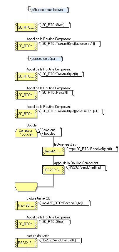

Hello Cubitus54, Thanks a lot for your reply. I don't understand the program very well, Do I need extra hardware to be able to communicate with the time keeper using RS232? I got a little confuse.

Hi Cubitus54, thanks a lot for your quick response. Obviously you are far better than me in this topic because I still lost, let me ask you, I've seen that you also showed me what I did wrong on my first attempt and some corrections done on it. This is how I should proceed? Or I should follow the second example? I will appreciate if you are more specific. thanks a lot again, I'm new in this communication components.Thanks a lot for your comprehension. See you soon.
- cubitus54
- Flowcode v5 User
- Posts: 110
- Joined: Wed Jun 19, 2013 7:18 am
- Has thanked: 7 times
- Been thanked: 32 times
Re: Time to suffer!!!
Hello Charles,
Sorry for my poor English, I'm French ... Thanks to Google translation ...
Hard for me to make great explanation in English ...
Here's my program with a GLCD display.
You can get inspired to run yours.
