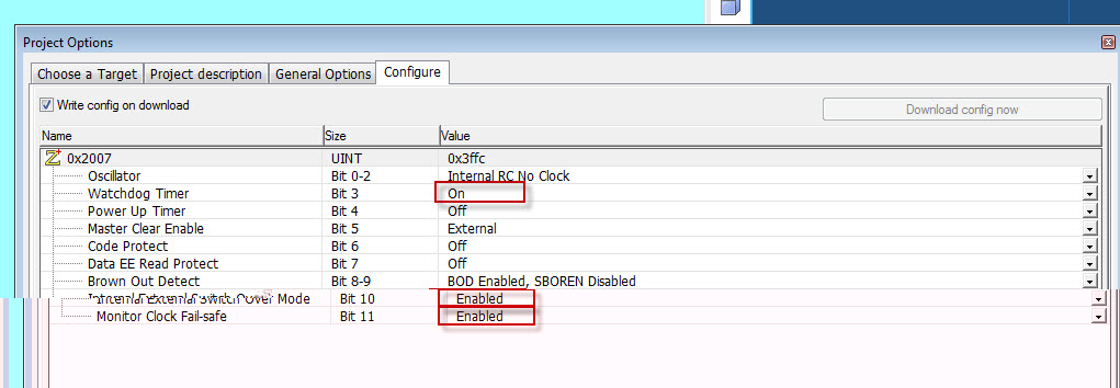

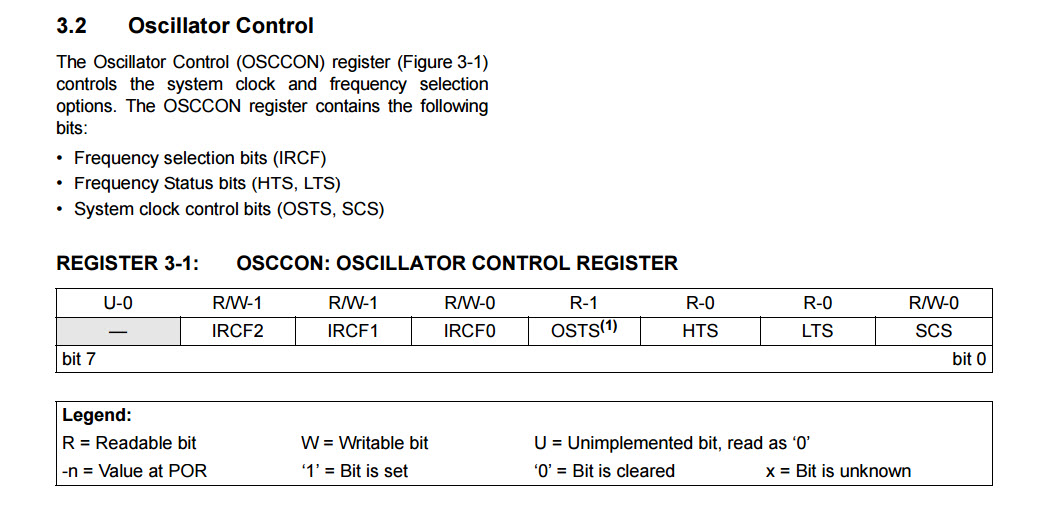

Re: Pic 12F683 with external RC or Internal Clock
In my opinion there are a few things you are not doing and that is the reason your internal oscillator is not working
(1) you have to use a C function call and set the OSCCON register to your needs
(2) if you are not clearing the watch dog in your FC diagram then you should not enable the watch dog timer
(3) why do you enable the Oscillator switch over mode as you are using the Internal OSC
Check the datasheet page 19 how to use the Internal Oscillator
My config is correct.
You clearly did not read my post properly
however if you believe your config is correct so be it , also if you do not want to set the OSCCON register so be it too
cannot make you do this hope you get it running
