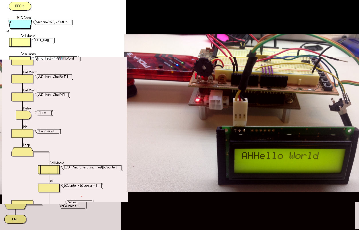

Target: PIC18F4580
Programmer: PICKIT3
OS: Windows 10 home 64 bit
FlowCode 6.1.2.0 (11.05.2015)
Send a 0x41 to the screen and it puts an "A" exactly as expected.
Send a member of the string array, and display prints junk
Tracing variable as passed to the serial send routine, it looks exactly as I would expect.
SOLVED: Problem sending character to LCD via UART/Serial
bvolken
- temp.jpg (64.2 KiB) Viewed 6316 times

Re: Problem sending character to LCD via UART/Serial
I know the clock and baud are right. I have run lots of tests. The only change is now trying to send a string (array) one byte-at-a-time.
When I pass "0x41" an "A" is displayed (confirming baud is right), but passing StringVar[4] does not work, even though it appears to pass a valid ASCII code to the print macro.
The CAL_UART is expecting a UINT parameter, and I am passing it a BYTE, which works when I pass "0x41", could this be related to the issue. I couldn't find much on variable typecasting.
Here you go. I can't help but feel it's got something to do with variable typecasting, but since it's only my 3rd day with Flowcode . . . who knows!?!
Should I download and apply "Flowcode 6 - latest components, bug fixes and improvements"?
Looking at the generated casm file, it looks like the typecasting is OK, despite it being logical to suspect it, and your code is very good for 3 days with Flowcode!
Have you tried?...
LCD_PrintChar('H')
LCD_PrintChar('e')
LCD_PrintChar('l')
LCD_PrintChar('l')
LCD_PrintChar('o')
I'm just fishing for more clues here.
As you say, updating to the latest is always a good idea
Have you tried?...
LCD_PrintChar('H')
LCD_PrintChar('e')
LCD_PrintChar('l')
LCD_PrintChar('l')
LCD_PrintChar('o')
In your config settings switch of the extended CPU setting. This is known to cause corruption with arrays. Then your program should hopefully work as expected.

Re: SOLVED: Problem sending character to LCD via UART/Serial
Okay, turns out the problem was indeed the "Extended CPU Enable"
After switching to "disabled", the code worked as expected.
THANKS FOR THE SUGGESTION!
