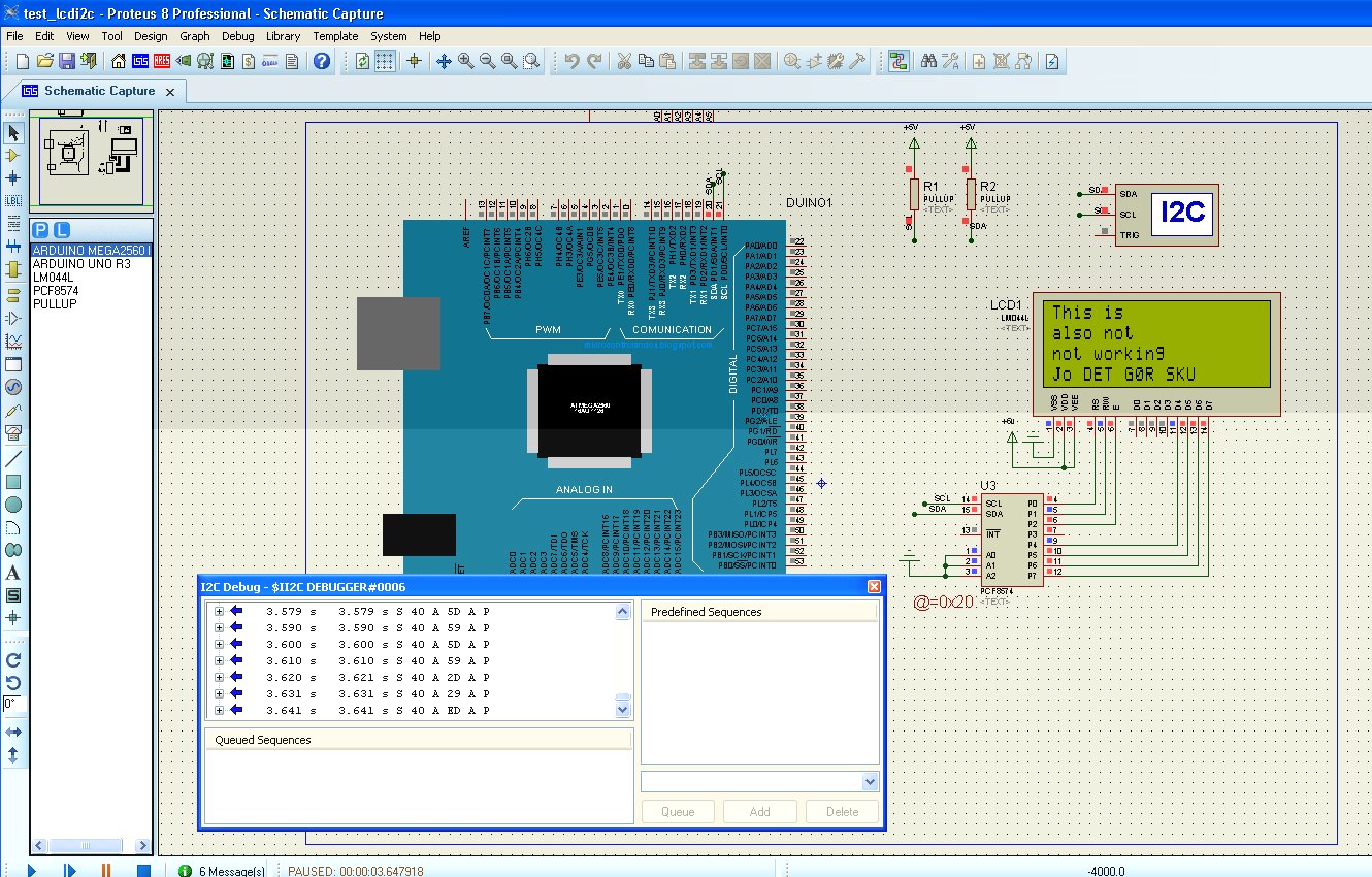

Hello Monie
I've made a test with my own schematic (Proteus 8.2) .
The flowvchart works fine if I choose "I2C hardware" (channel1) .
I don't see your pull up resistors (SCL ,SDA) .
Daniel
(312.91 KiB) Downloaded 1052 times

Thanks for your reply.
But do not be able to get I2C to operate so it can be anything in the display.
Tried to correct but can not get I2C for Display to work!
Hope you will be helpful for a solution to the problem
Has attached the edited diagram:
And attached coderne to Proteus:

Hello Monie
I can't open your file (Proteus v8.5) .
here my project (v8.2).
Daniel
test_lcdi2c.zip
