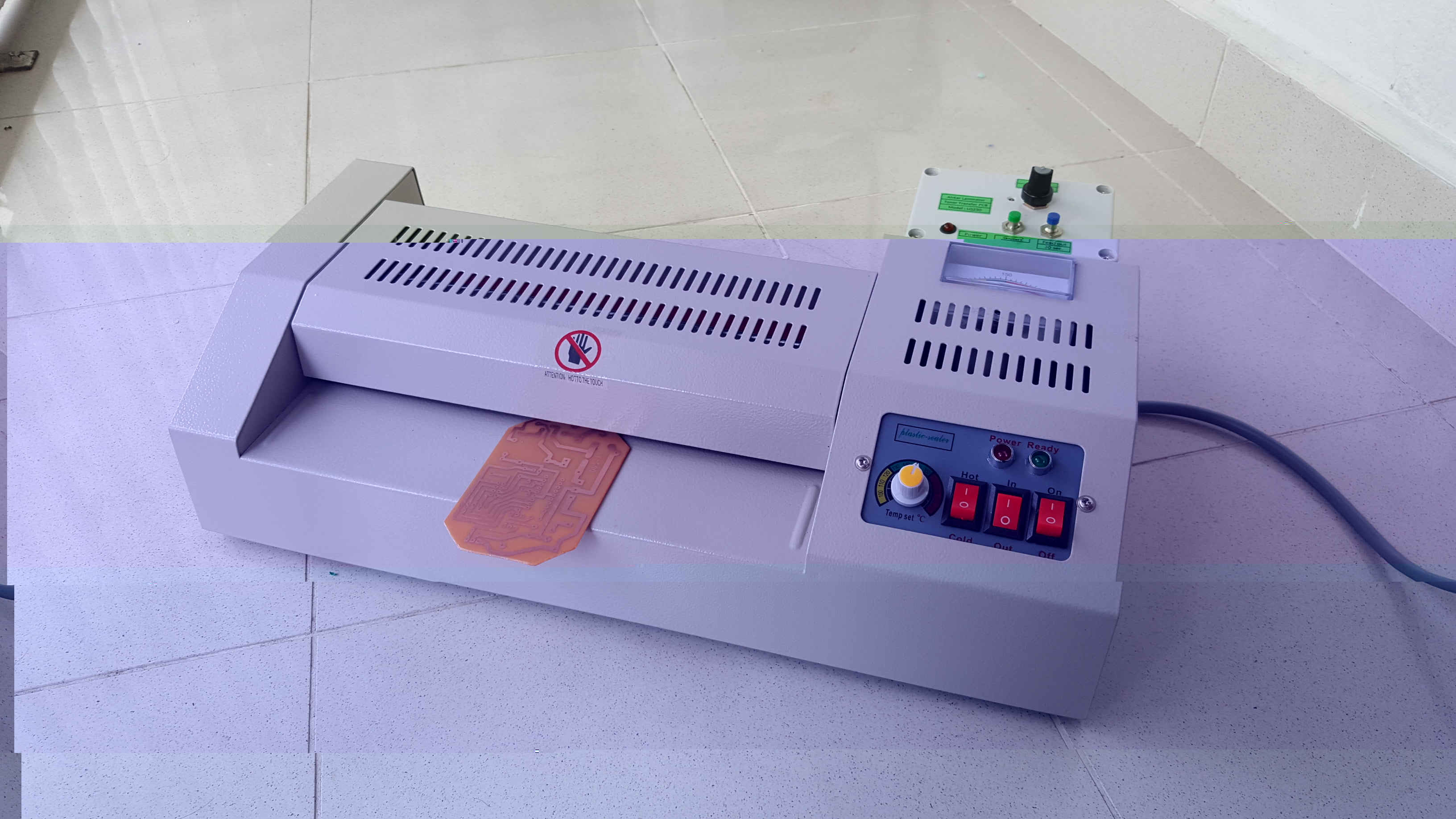

Re: Learn how to use weak pull up in 16F628A
Hi, all
1) Just to complement this learning, I would like to share this image photo to anyone who is interested in
this project/product.. This project is called " 1 GO toner transfer PCB laminator " I am using this laminator
for my hobby to made PCB.. It is very easy, fast and cheaper on cost of PCB..
2) I am attaching the image photo for your viewing.. Thanks for flow-code, Benj, Martin and Dazz.
3) skquah2007@yahoo.com
- 1 Go passed, toner transfer laminator
- (609.76 KiB) Downloaded 4622 times
Here is the laminator image photo.. skquah2007@yahoo.com
- Laminator used for PCB making
- (1.16 MiB) Downloaded 701 times
