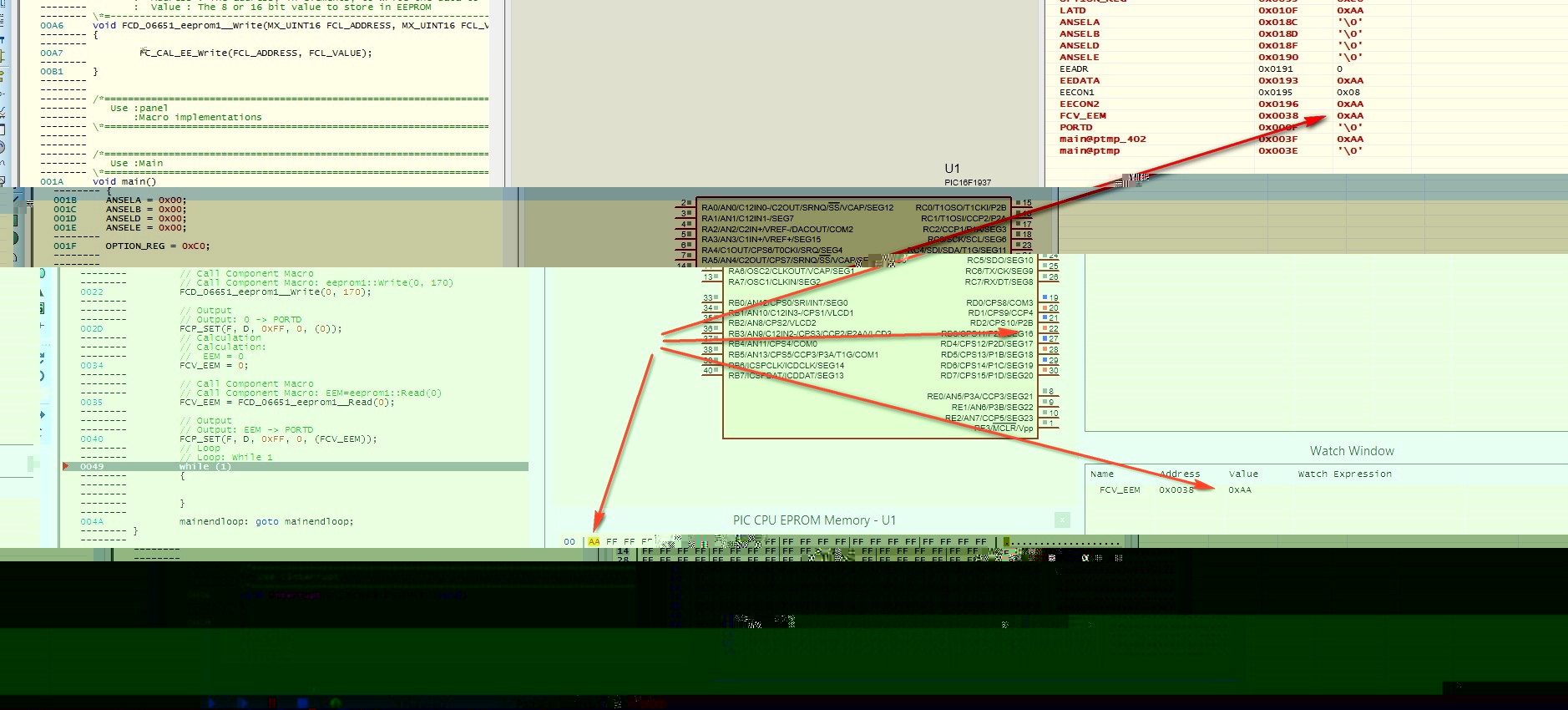

And with my not working .....
(414.31 KiB) Downloaded 993 times

Hi paul!
Put update FC7_Latest_Files_040816.
EEPROM began to work !!!
But only a comma.
Through the point enters an incorrect value.
Regards Slava.

Hi! Thanks Martin! I received the update, EEPROM works !!!!
Regards Slava.
