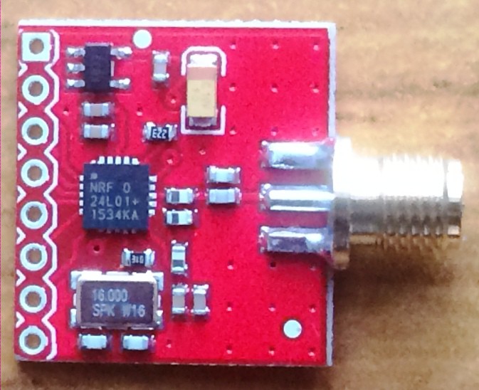

My new NRF2401 boards & aerials have arrived.
Tested using Bens component and FC programs, Though tweaked to use a pair of EB006V9s and PIC16F1937's as I don't have a EB091.
Pleased to report it works fine sat on the bench. Now to see what sort of distance it will connect over.
Before Soldering Headers
Rubber Duck.JPG (56.8 KiB) Viewed 22224 times
