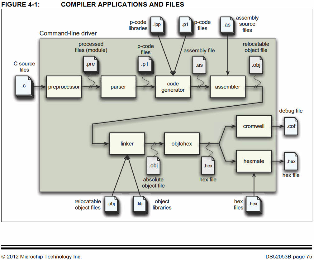

Has there ever been a discussion or explanation of the files that are created during the compilation of a flowchart into a hex file?
Obviously, it is easy enought to see which files are dreated by the <compile to hex> request, but I have searched high and low (both within Matrix and across the global internet) to find out what the purpose of each created file actually is, but cannot find anything useful.

It would help if you post your flowchart. Now we are left guessing. With regards to the files, have you checked the compiler documentation for XC8? The only file generated by flowcode is the .c file, everything else is compiler generated.

I intentionally did not include my .fcfx file - as my enquiry was actually primarily looking for information on the compilation process itself.
However, in the meantime, I have downloaded the (huge) XC8 User Manual, and found some specific information that has helped me answer my own question:-
The interesting behaviour is that, if I recompile for an 18F4331 (instead of an 18F2331) the problem disappears
