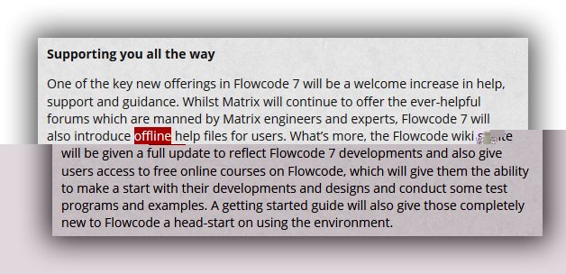

In August
in this very post
it was discussed that Flowcode7 will offer offline help.
I can't find it yet but I would welcome an offline solution indeed.
