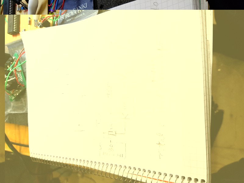

Dear adviser
I tried to get the display showing the inserted data, I designed one more the same kind
of circuit as my last project I did make the change
as I received the last information to make change in timing the display to one second (No display action )
The reason that I made a new design unfortunately I can´t reopen any one of my designs
after it has been inserted in an IC I don´t know why.
please look at Attachments
Note; if it is not possible to solve the problem in communication I can come to you to show me if you have the time for it I had this problem with FC4,5. 6 & now it is withFC 7 to

hey dear adviser
here I send you the drawing of the switching transistor circuit as I have mentioned in my last post
wr
nasim
Note: the last two Transistors in second drawing are NPN.

I suggest removing the IOC Enable icon.
You should see a pulse on the processor B0 output, for at least 5mS
Your circuit 1 will work, not so sure about circuit 2
