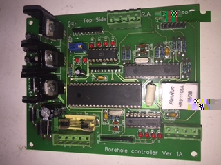

the pcb board is my own design, it incorporates the Hanrun board onto my own pcb.
the PCB boards are mounted at boreholes up to 6 Km away from the PC, it uses outdoor Wi-Fi access points.
and here is the problem if comms is interrupted whilst sending or receiving data it locks up, this is a good possibility due to the circumstances.
to solve the problem I activated the watchdog, and the very first thing I do before initializing the component force the reset to low for 3 seconds then raise it high and finaly I initialize it. this worked to reset the component. however winsock had also locked up, so all I do is send a command instruction to clear the ARP table."netsh interface ip delete arpcache"

- IMG_3451.JPG (42.7 KiB) Viewed 4690 times
