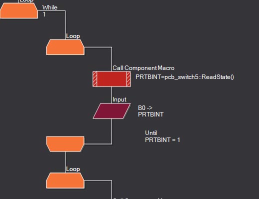

Thanks ever so much for your help. Yes, it work brilliantly. Couldn't get my head around what I was supposed to do but this is what I ended up doing to get it to work:
Key Mappings FC7
Key Mappings FC7
However, I still needed to do what you had suggested to get it to recognise the port interrupt by 'Reading' to port via a switch added to the panel and setting up a macro to Read it's state. Work like a charm.
Macro added
Macro added

I am now able to fully 'Debug' using simulation.

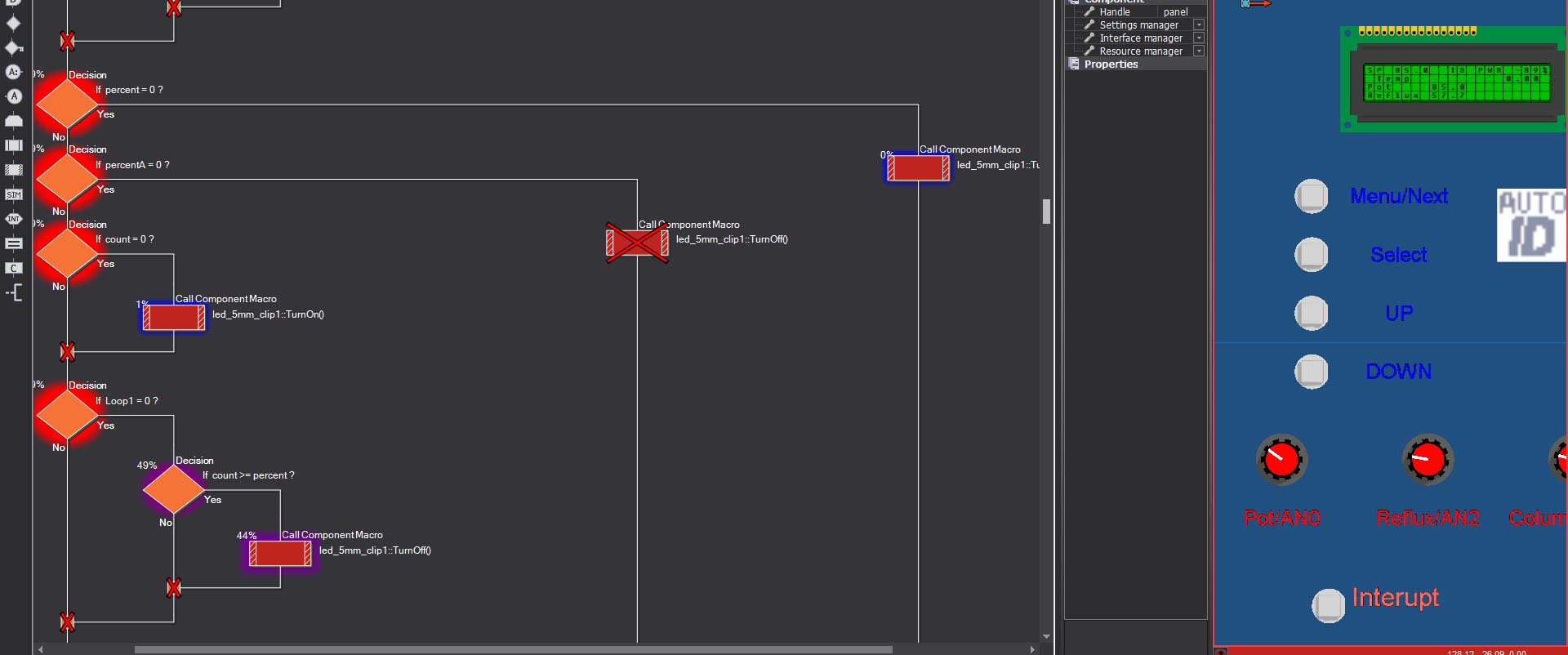

Core Profiling works extremely well, I have found a bit of redundant code using 'Code profiling' feature. The percentage output control logic for the TRIAC controller, using the fuzzy logic to check percentage output for each state is never triggered at this point. Why this is happening, well I am now able to investigate my train of thought before testing in the field. this branch of code would probably have never shown up without the profiling feature.
(131.04 KiB) Downloaded 1210 times
I really do like this even more every time I use it.
