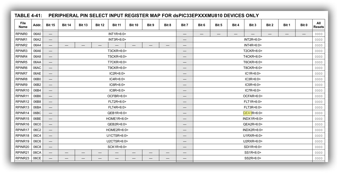

Re: Quadrature Encoder Interface (QEI)
Trying to study the datasheet reveals
http://ww1.microchip.com/downloads/en/D ... f#page=101
Here I am totally lost - how to get access to QEI1 and how to pick the right pins
Can anyone indicate how this is translated to C-code to initialize the chip ?
Best regards
BO
Best regards
BO
Looking at the datasheet Page 211 shows the input pins and the register to which a certain peripheral maps to
in your case QEI1 maps to RPINR14,then page 234 shows you this register and the binary number you should write in the RPINR14 to map QEIA or QEIB
The code would look something like this provided you have select "allow multiple remapping" in the configuration
You have to deceide to which pins you want to connect the QEI and then map the QEI to these pins
RPINR14bits.QEA1R = 0b1111111 // This map the A signal to RP pin 127- Attachments

meaning that it would be equally correct but less readable (?) to write _QEA1R=0b1111111
in the Flowcode Init Icon,
An other small detail
I think there is no RP127, It should be RPI27
If suspicion is right, Could this be correct ?
RPINR14bits.QEA1R = 0b0011011 // This map the A signal to RPI pin 27
It seems to be RPI for input and RP for output(?)
It would be fun and useful is this will work - still much missing probably,
Anyway the reposition of pins seems super smart
Even a virtual connection between output and input is possible without any physical pin
Best regards
BO

In my opinion you should be careful with this statement as in my understanding you can map RP pins to outputs and inputs but RPI pins can only be mapped as inputsPicoPuls wrote:
therefore I think my statement needs no correction as my examples does not refer to your exact chip it refers to a general description therefore you have to see what pins you have and what you want to use with the information given to you
Regards QMESAR
