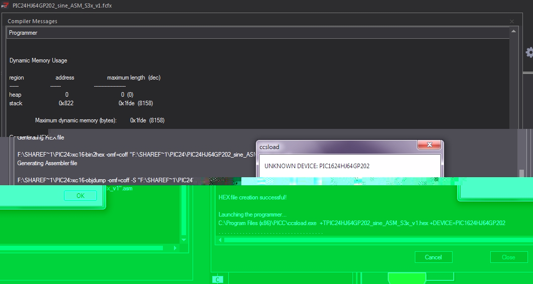

How can we add "PIC" in front of chip name?, because now is seen only as 24HJ64GP202 instead of PIC24HJ64GP202.
FC7 parameters sends info to the programmer as "24HJ64GP202" and it seems that ccsload.exe needs PIC24HJ64GP202.
Re: Third party programmers
OK, I managed that by adding in front " $(platform) " as described here:
https://www.matrixtsl.com/wikiv7/index. ... er_Options
but I still get an error.
The problem is solved. Everything works fine. Thank you for your help.
