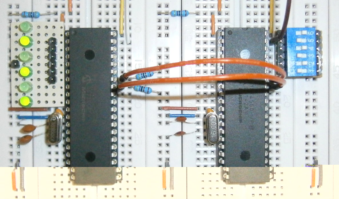

The test was performed using a breadboard as in photo below and I captured the I2C signals with a DSO that has I2C decode function.
Besides that I have tried the same code by simulation the project in Proteus. The virtual oscilloscope in Proteus shows the same signals as the real oscilloscope. That proves that is nothing wrong with the hardware/connections and it is only a problem of code, how the I2C is setup to work.
With these being said, I consider the provided examples from Flowcode Wiki Help not functional and not tested.
Could you debug them and make them functional and test them with real devices?

viki2000
Posts: 190
Joined: Mon Jul 07, 2014 9:38 am
Has thanked: 30 times
Been thanked: 77 times
Re: PIC to PIC over I2C – Default Examples
Post by viki2000 »
As promised, I have made the circuit diagram/schematic of the real circuit that I have used on breadboard tests.
To emulate as close as possible the real breadboard, I have use Fritzing (http://fritzing.org/home/ ), because is free and another program as Virtual Breadboard (http://www.virtualbreadboard.com/ ) seems nice, but is not free.
Below are the breadboard and schematic as pictures and the Fritzing project.
Because the default LED Bar graph has 10 positions and I did not spent time to modify that component for 6 positions as I have in reality, I just connect fewer positions, in fact 5 positions, because another component, the resistor pack (array) was with 5 positions. The same with dipswitches component, has 8 positions and I have used only 5, to correspond with 5 resistors and 5 LEDs. In reality I use 5V stabilized power adapter, not batteries.
(186.31 KiB) Downloaded 11442 times
(78.54 KiB) Downloaded 11442 times
I2C PIC16F1937_1.zip
Post by viki2000 »
Then I have made the electrical diagram below in a photo editor, which reflects better the connection from real breadboard.
Here we may object to the missing pullup resistors to 5V on the dip-switches, so when the switches are opened, then the inputs are in an uncertain state. But we can enable the pull-up resistors on PORTB with a C code.
Nevertheless, if the states would be uncertain and oscillate, then I should see the LEDs also oscillation on/off. If I close the switches, then the inputs are connected to GND with 0 logic state. Even in this case the LEDs on the Master are on all the time, indicating that I2C is not working.
If we look at the oscilloscope screenshot above, then we see indeed that is a problem with the Slave. The Start initiated by Master is present, the 7bits of the Slave Address is sent by Master, the 8th bit R/nW bit is 0 indicating a Write operation, but the 9th bit which is Acknowledge and comes from Slave is 1, meaning NACK (not acknowledge), so the slave does not respond.
Can you tell me what Revision ID have your PIC16F1937 chips?
I will try now what you suggested.
I2C PIC16F1937.jpg (119.11 KiB) Viewed 23625 times

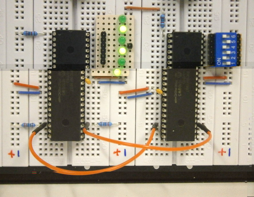

Here is a short update, it seems I arrived somewhere.
I followed your suggestions: I connected both Vdd/Vcc, then I changed the MCLR resistors to 10K and pull-up resistors to 3.3K. But I think these did not make any changes.
Then I tried your proposed code “PIC16F1937_I2C_Slave_switches2 counter.fcfx” by disabling PORTB read (did not read anymore the switches) and the LEDs started to work showing/changing the numbers in binary format.
I checked the I2C bus with the oscilloscope and it looks good now, I have the ACK bit from Slave. Maybe I will post some screenshots during the next days.
It seems the reading of the switches is the problem, in my case PORTB.
I can assume for the moment only next possible failures:
- Missing pull-up resistors and uncertain state for inputs. By the way how do we enable with C code the pull-up resistors on PORTB?

The circuit works now.
The last problem was related with pull-up resistors on PORTB, because I did not use any external resistors attached to the dipswitches.
It works also if I use 4.7K resistors for MCLR instead of 10K and if I use 4.7K resistors of I2C resistors instead of 3.3K. It works also if I use the VDD/VCC connections on only 1 side of the PIC16F1937.
To recap, the problems were as following: Atmega MCU instead of PIC16F1937, then OSCCON=0x7A; - mistakes on the given original examples and the last one, my mistake, pull-up resistors on PORTB.
PIC16F1937 allows setting individual pull-up resistor on each pin of PORTB.
Because I do no use a dipswitch with 8 positions, but only with 6, connected to the pins RB7-RB2, then I set up the pull-up resistors on PORTB only for RB2-RB7, so instead of WPUB=0b11111111=0xFF, I used WPUB=0b11111100=0xFC;
Here is a photo with the working circuit on breadboard:

Looking at the last breadboard photo above:
- The Master is on the left side and has LEDs attached to the PORTB:
- The Slave is on the right side and has dip-switches attached to the PORTB.

For who is interested, I have tried also PIC18F4550 on the same breadboard and works, of course with a bit different settings for ports, register for pull-up resistors and oscillator.
This time I used an external crystal 16MHz and with internal PLL I have 48MHz clock for CPU.
I use PORTB to read the switches and PORTA for LEDs.
Here is the breadboard setup with PIC18F4550 on top and previous PIC16F1937 at the bottom:
Full breadboard.JPG (154.72 KiB) Viewed 23507 times
Here is the code used for both situations:
PIC18F4550_I2C.zip
(10.51 KiB) Downloaded 471 times
