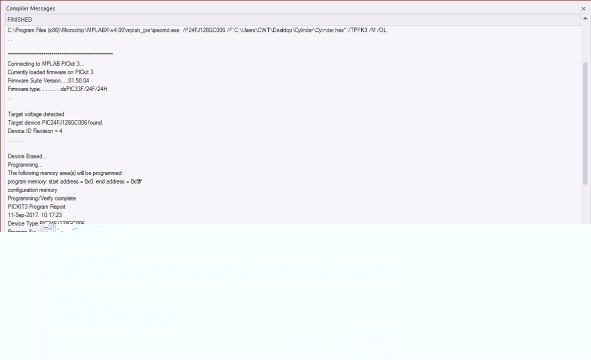

I used the external powerd PicKit 3 compiler option settings for 16 bit pic and then went to create the hex file.
At first it complained that it couldn't find the PicKit 3 and failed to create the hex file, I don't know why as I only wanted to create the hex file.
I gave in and connected a Pickit 3, same thing almost it complained about not finding the PIC chip. and failed to create the hex file.
I connected the board with the pic chip on, tried again and OK it created the hex file but it also programmed the Pic chip! Not what I wanted or expected, no warning it just did it.
Output window
Output window
That all seems fine if I wanted to program the chip but if I only want to create the hex file do I have to then mess about with the compiler options again (put back to original) before creating the hex file??

I know it should but that is not so, I used the compile to Hex and it programmed my chip!
