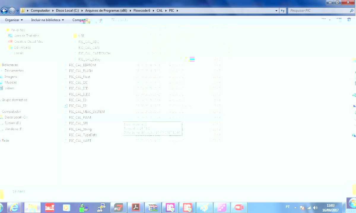

Re: PWM Control with led using PIC18F87K22
Hi Medelec,
1st step: I do have the version you´ve mention on last post: 6.1.4.0(08/11/2016). I also attached the file to replace the existing pmw cal into the pic folder in c drive.
After doing the 1st step, I decided to run the code considering the tips about the C code for configuring pins during initializations for analog or digital, as you said that flowcode takes care of it if left out of the flowchart.
I also performed tests including and not including the leds and equaling the current_duty to them. It also did not work the fading of leds. But indeed it turned them on and off but as if they were digital 0 or 1, no fading. If I take the leds off of the code they dont even light up on my board considering they are functioning right and the dipswitches are enabled. Which means, if I only leave the component macro for pwm to be outputting the variable current_duty that I called pointing to the C2 or C1 in the macro properties, when download into the hardware the leds dont even light up.
Well, If you have any other tips I would appreciate very much
Thank s
Rod

Can you look in the \Flowcode 6\CAL\PIC\PIC_CAL_PWM file and let me know from properties the exact size, and modified date.
If you have the correct version and Flowcode has been restarted since replacing file, then PIC18F87K22 PWM requires further investigation.

So it looks like you have not updated PIC_CAL_PWM.c properly or reloaded your flowchart since replacing the file!

If you download it it should show the modified date as the date you downloaded it, Not the 18/12/2015
So try re-downloading and replace existing
I have double checked and the file I posted is the correct version.
Make sure the file you have is not from 18.12.15: Notepad++ has a plug-in that allows you to compare files with text in.
PIC_CAL_PWM.c
Hi Medelec, I modified the file as instructed. The program worked only for C2 output. The C1 output does not fade at all. It does not light up, it stays on 0 all the time.
