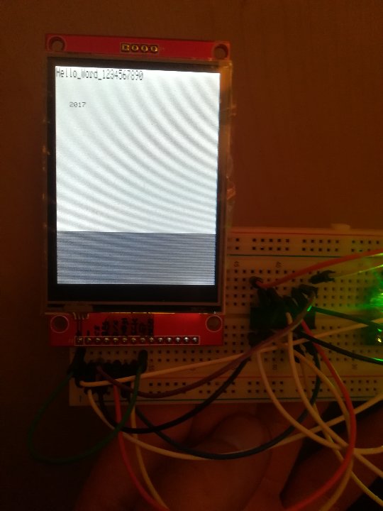

I'm using the display and Arduino Nano (http://www.ebay.com/itm/2-8-TFT-LCD-Dis ... 2749.l2649)
The problem is that the slipped part of the displey is black. What am I doing wrong?
The file for GLCD (ILI9341) FCPX is from here (http://www.flowcode.co.uk/mmforums/viewt ... 203#p71203)
I attach a test flowcode program and an image.
Thanks for the help

Just a guess... try:
Pixel Height 320
Pixel Width 240

EDIT- I tried it. I tried it and it works very well. Thank you, LeighM!
