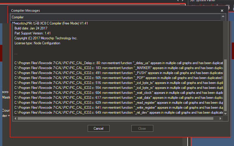

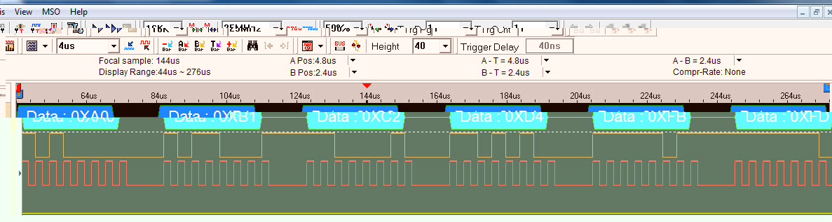

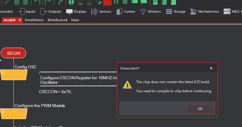

Hi Team.
I am trying to debug a Flowchart with Flowkit 2 on a PIC18F47J53 and as you will see the ICD doies not functioan at all
the general popup comes up and say there is no code for ICD as you will also see <I compile to chip with ICD switched ON and program the chip with this switched ON ICD and then I do a reset before I run the ICD as you will also see there are a number of errors/warnings reported during compilation.
Please can you help out here I am in the middle of a proto-type design.
Note the code runs fine when I only compile to chip all is great and the mcu is running well another confusion I have with FC during simulation the running cursor will never enter the macro's (using low speed debugging and also placing a break point in the macro the break point is never reached so I want to ask this should the macro's be executed in simulation.This is not pc related as I am using it on a WIN7 and a WIN 10 machine both shows the same result
Is the macro supposed to be simulated or NOT ? the logic analyser print shows that in real time the macro is executed correctly but during Simulation nothing.

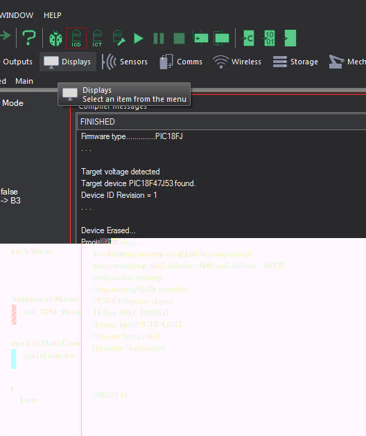

Re: PIC18F47J53 ICD (Flowkit ) Not working
Hi Team.
The same issue exists for the PIC16F1508.

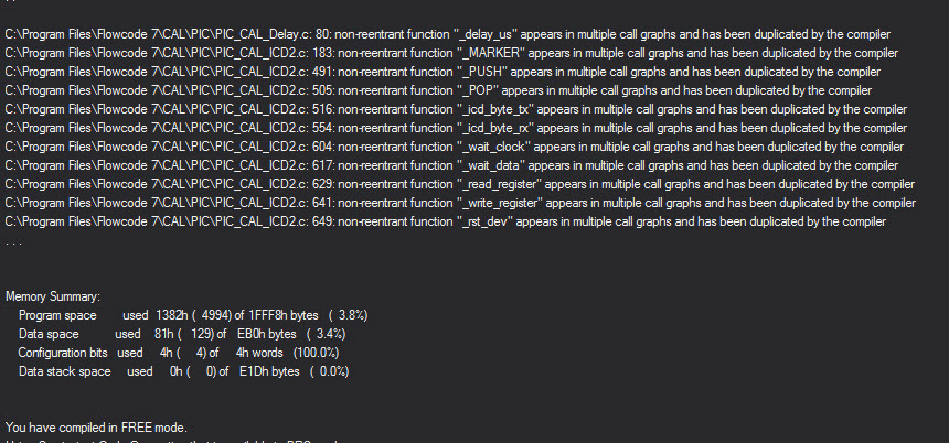

Hi QMESAR,
Which particular macro are you having problems with the breakpoint in simulation?
The compiler warnings look OK, and I don't think these will be any cause of the ICD failure.
The references to _MARKER etc confirms it's an ICD build.
Could you try disabling the TMR1 interrupt and see if the ICD then runs correctly?
