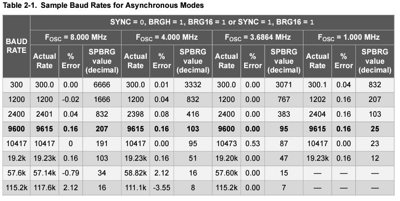

I am trying to use 4Mhz crystal on a 18F4523 and 1200 baud rate on UART and the code is not working correctly.
I have successfully use custom baudrate of 1200 on the same device but the crystal frequency was 19.660800 Mhz and the C code at the beginning of the program was as below:
TXSTAbits.BRGH=0;
BAUDCONbits.BRG16=0;
SPBRGH=0;
SPBRG=255; //this value is for 1200baud rate
What is the settings for 4Mhz crystal on a 18F4523 and 1200 baud rate on UART?
I tried to use the table bellow but the program is not working correctly.
Thanks in advance

You don't need code for 1200 as that is not a custom rate, you just choose 1200 within UART properties.
Just make sure the timings are correct with a one-sec flasher test first.

I tried to set the baudrate at 1200 in UART properties but it is not working. Note that i want to use software defined pins and not the default hardware pins. Does this make the difference and the program is not working at 1200?

Yes, on V8 it does.
Getting the baud to work at the correct rate for software on all targets is very time-consuming.
For example, my target device is 16F1937.
I have set the software baud to 1200. The measure baud is 917 = 23.6% error.
New to V9, there is a UART software (timer) component that uses a timer interrupt to generate a baud which is bang on the money.
With V9 even though 1200 is a standard baud rate, you will need to use custom to get it working.
A tip I always used to determine the UART baud rate.
Send a string with U it must be in upper case.
measure any single pulse width.
Baud = 1/singe pulse duration.
I did that for 4MHz and with a custom baud set at 1719, the baud is 1251 on hardware.
You will be best having a slightly faster baud as if you have any interrupts, the baud will be slowed down.
