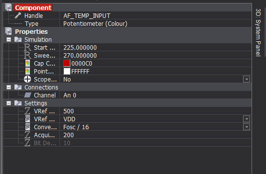

Hi Team.
After fixing a few things on this device family we have the next issue ,
(1) you will see in the attachment the ADC is specified as 10 bit which it is not it is a 12 bit Converter.

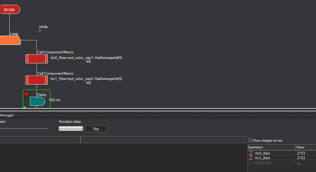

(2) None of the ADC reads work ,I have tried them all on real HW (EB006 with various voltage at various AN pins)
Note I can see the captures in Ghost .

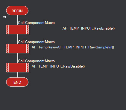

Note below a capture of trying the Raw read however I tried All function calls none work on this chip.

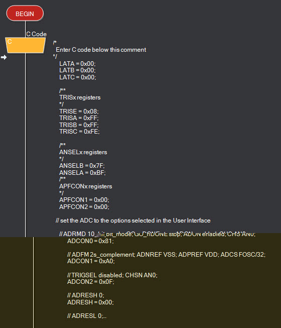

Hi Leigh.

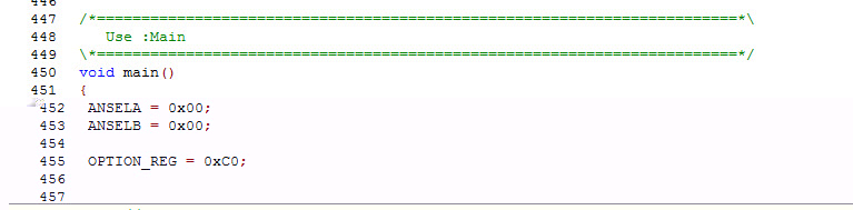

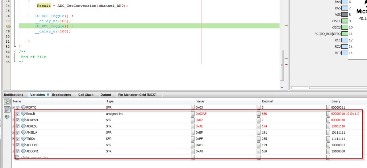

Here is the MPLABx Project in which you will see the ADC is working ,I tried both 12bit and 10 bit conversions.
In Flow code what concerns me is that the ANSELA andANSEL B shows 0 and from MPLAB Code configuration ANSELA has 0xBF (only AN0 is configured so it is correct in my opinion.

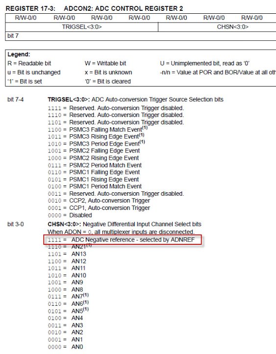

As you see here the ADC is working and the values of the configuration registers.Note that it is possible to set 10 or 12 bit conversion on this chip with 2 complements or signed values as return from the ADC (Right and left justified) also I think FC set the ADCON2 register incorrectly which selects the ANDREF ADC Negative Reference VSS or a AN Channel
MPLAB project attached you can use it or the hex file to test if my findings are valid

Leigh.
Here is a FC project which I included the settings for the ADC in a C call and it runs prefect ,however no go with the FC ADC component there
is certainly something wrong with it

Comparing your register settings with ours, two differences:
You have ADFM set, so result is in 2's compliment, not sign-magnitude
You have ADRMD set, result is 10 bit, not 12 bit
So the result meaning will be different.
I'll need to have a chat with Ben to see what we think about supporting these options
I think you have something of note with the...
ADCON2 = 0x0F;
looks like that is needed to set the Negative Ref to be selected by ADNREF
Could you try just adding that one code line to the Flowcode component test?
Leigh
