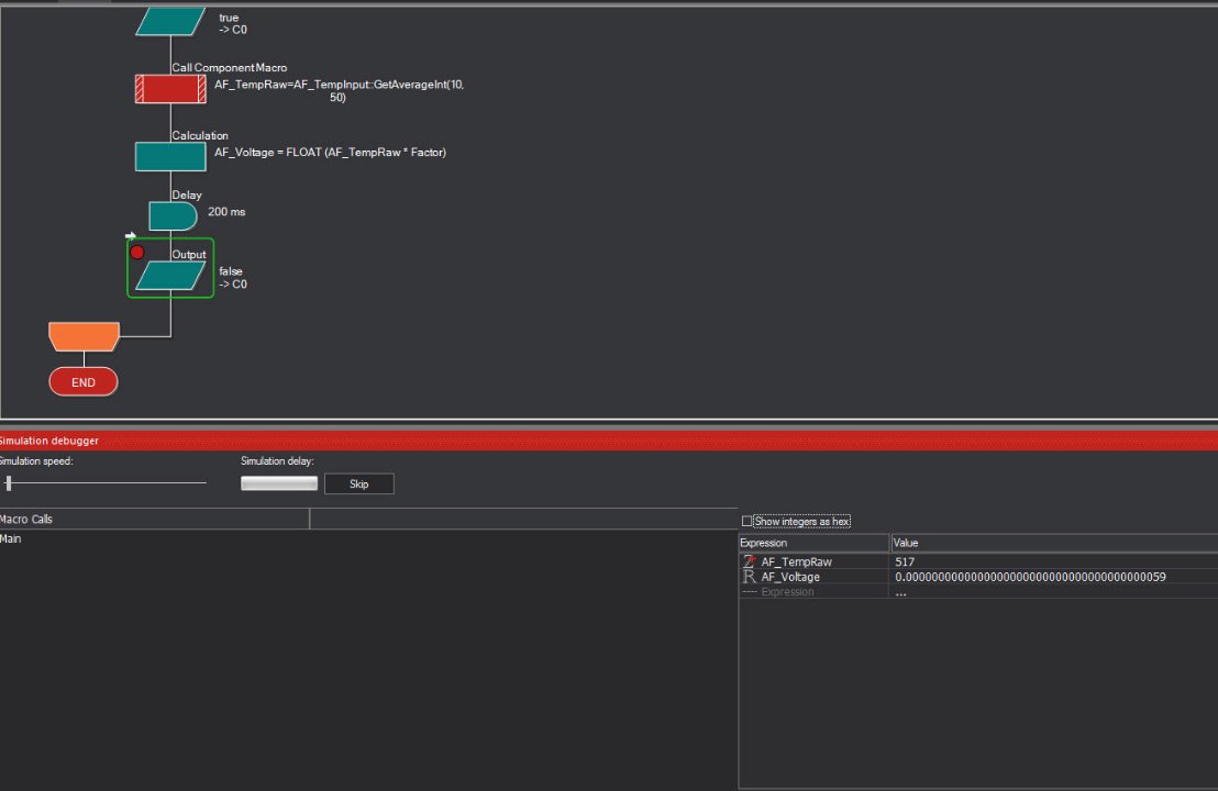

Hi guys
PIc16F1937
As you will see when I read an Analog Pin (getAvgInt())and do a float calculation in Simulator it works fine however when using HW and Ghost (EB006V9)
the float result always show 0.0000000000059 :D although the getAvgInt() function returns a good value, The same thing happens when you do a GetVoltage() ADC read the returned Voltage always show 0.00000000059, I also tried doing a explicit type cast to float ! The reason I tried to calculate the voltage myself is that the getVoltage() adc call returns the same o.0000059 value .Please can you help out here I feel like spamming the Forum with all my reports :oops:

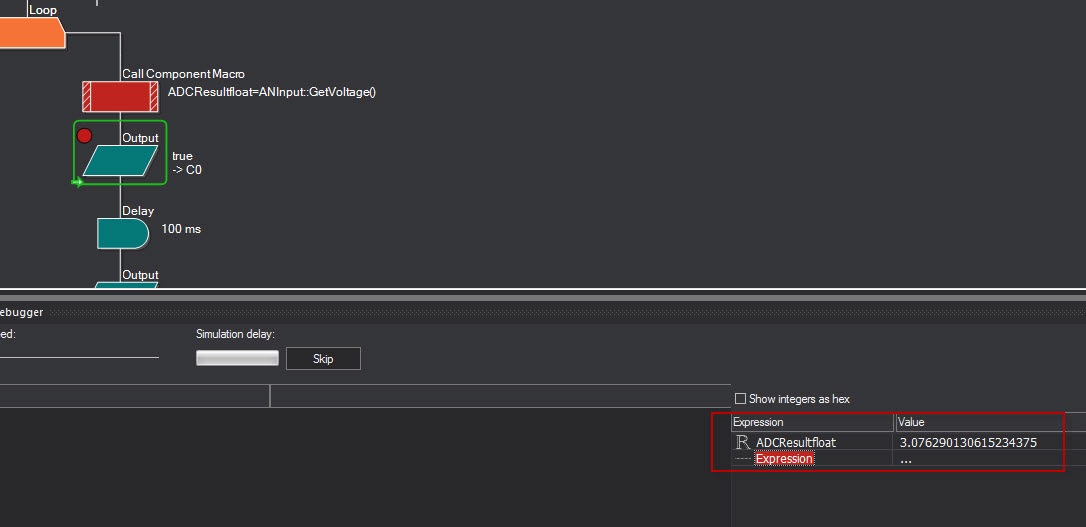

Hi Guys
Hete I have made a screen print of the getVoltage ADC call you will see the flaot returned is 0.0 in the debug window and I also add a multi meter print of the voltage at AN0 pin ,if I do a getAvgInt read on the pin it shows the equivalent value of the multi meter value in bits that is fine , my problem with FC and the Ghost is float calculations and the ADC call getvoltage() in my humble opinion they do not work I need your help to show me what I do incorrect or fix the problem :D

Update I can confirm it is again the famous Ghost /ICD that is causing the issue
(1)I read the ADC with getAvgInt and GetVoltage and then write the value out on the UART perfect correct that means that the float calculations and the get Voltage function is working but you can not see it in the ICD
