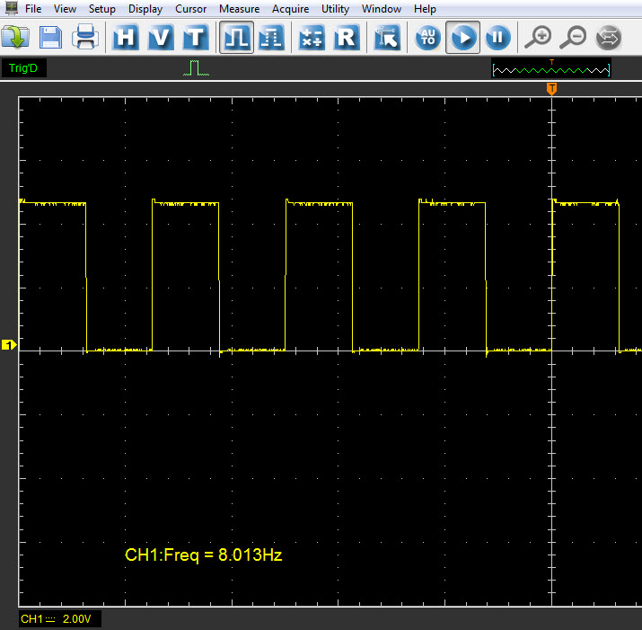

Here the output from MPLAB generatde hex file

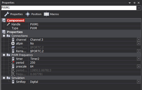

The FC configuration
Interesting is that the 1704 only has PWM channels 3 and 4 in HW, however Flowcode allows me to select Channel 1 -4 ,however the correct config is shown a above .my feeling is that the PPS is not set correctly for the Pins I might be wrong however it would be great if you guys could find the issue
and help out here.I also tried both setDuty and setDuty10bit no result
Please help :D
