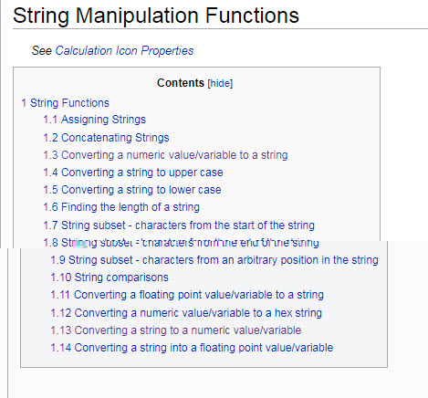

You can look in the Flow Code wiki for help on such questions.
http://www.flowcode.co.uk/wikiv7/index.p ... =Main_Page
If you Tipe in the search String functions you will see a few things that might help you
Then if you Search for Type casting and Number Conversions you will also see some valuable stuff
Hop this helps you

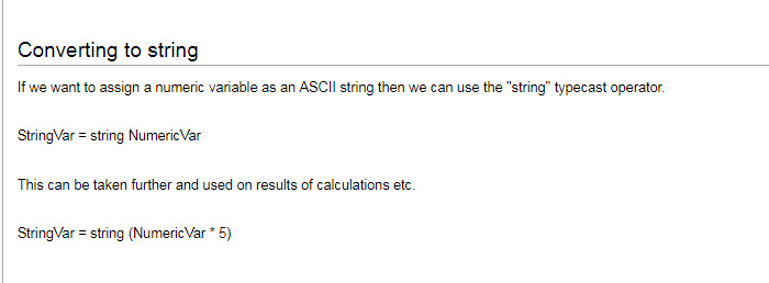

What you want to do is in the wiki which I gave you the link to any case in basic
the Binary value of 0b01000001 = 65 in decimal in both cases the compiler does not care if you give a bin or a dec number for the compiler it is a number and will automatically covert it with that said 0b01000001 = 65 when you use the ToStr$(number) you will have the A as you see 097 is not A in ASCII ,A is 0x41 in HEX
