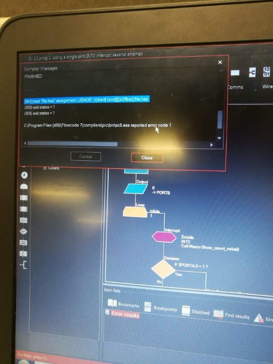

Hi All,
I am having trouble with a compiler error message. I have copy and pasted the program and inserted the program into a new one, which means the error code does not show and compiles perfectly. However, I have tried another program and done the same which still comes up with this error code when compiled. I wondered if it was due to using a interrupt but I have compiled the original program without the interrupt and it still does the same. I have attached the error code which is shown when I compile the program,
Jacob

Have you tried to eliminate any file name issues?
Just try save as a very basic name e.g.
My Flowchart
If not, Won't be able to help further without the flowchart being attached.

Ok thanks I will try saving the file as a different name, and I will get back to you to see if this has resolved the issue.
Thanks for your help, but just out of curiosity why would this allow the program to be compiled? Is it because the file name I've saved it as is too long complicated?

Jacob1 wrote: but just out of curiosity why would this allow the program to be compiled? Is it because the file name I've saved it as is too long complicated?
You need to bare in mind that it's a pure guess as I have not got your flowchart to see what the issue could be.

Thanks for your help with this compiling issue, removing the "," now means the program compiles perfectly! Very grateful indeed for your help :D
