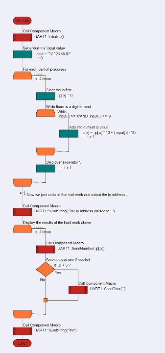

- Posts: 1208
- Has thanked: 70 times
- Been thanked: 440 times
Re: Uart Rx Byte to Variable
Okay - this parses an input ip address in the format a.b.c.d (ie 112.1.22.122)
- note that the ip address should be in the correct format (ie 4 values 0..255) and NO allowance is made for variations (for example spaces, extra '.'s, missing values - allowing for every possibility makes the code much more complicated !!! ) Note also that your input string must have a terminating nul \0 (actually any non digit character would do) - you did remember to add a \0 to then end of your input string ?
The first 'half' does the hard work - the second half just reflects what we calculated to the UART (to check it works!)
To save the typing. Hope it helps...

Adding the calculation macro
Should do the trick (but note my previous comment about all the ip address being within SIZE bytes)
StringIP[index] = '\0'

Another possible problem:
If SIZE is greater than the length of StringIP (20) - and after a '[' character is received there is no terminating ']' (due to a corrupted block or some other problem) then Ass_IP will overwrite memory causing a crash or subtle bugs?

Try adding some debug statements
So - for example - send StringIP to UART after receiving it.
What have you tried so far (did you implement the above/get rid of the StringIP ="") - any idea where is it going wrong?
