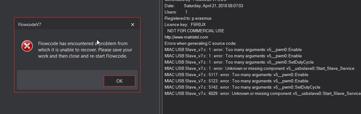

(1) Down loading the files from the MIAC resource page the files contain Examples for FC5, FC6 and FC7.There is also a folder LVINT which contains 2 LabVIEW examples and the FC MIAC USB Slave Source code (firmware Folder)
This FC Source code does not compile at all there are a number of errors reported as you can see here.

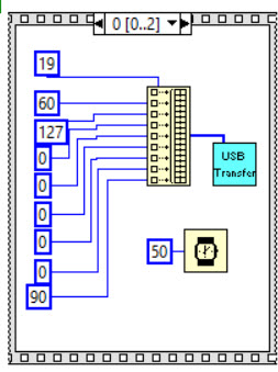

one issue I have been picking up is that I can transmit a CAN message but the command to change the CAN buffer data (19) never writes the new CAN data to the Buffer .

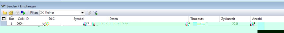

Here is a screen print from my CAN logger as you will see the Message is sended evry 50mSec with the preloaded data in the TX buffer
Now loading sending new buffer data from LabVIEW to the MIAC never updates the Data in the Tx Buffer
sending new data to the MIAC
and transmit the message the Data never changes
Team please help me to solve this confusion with the source files It seams that the MIAC firmware only excepts a 3 byte string and handle it correctly every thing more than 3 bytes long is handled incorrectly as the 9 byte CAN set buffer Command and string /Array.

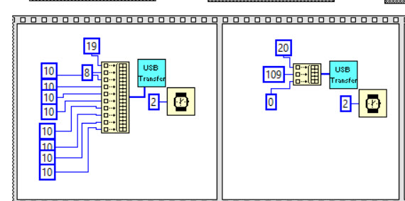

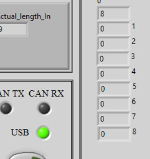

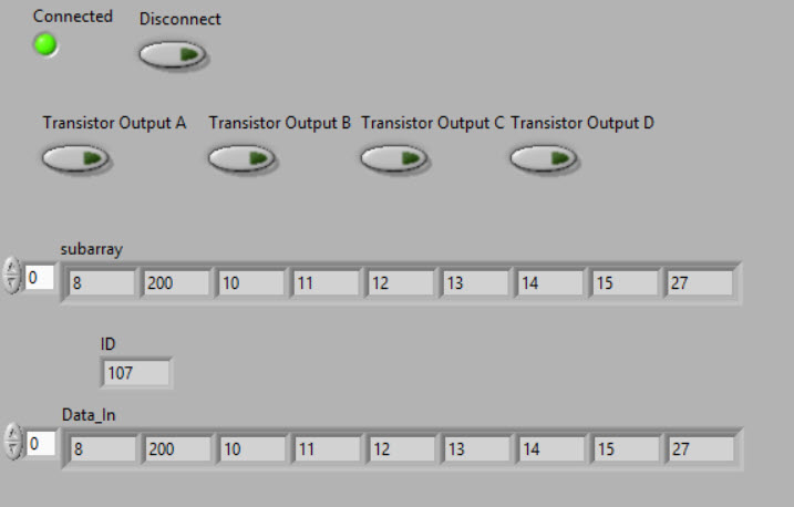

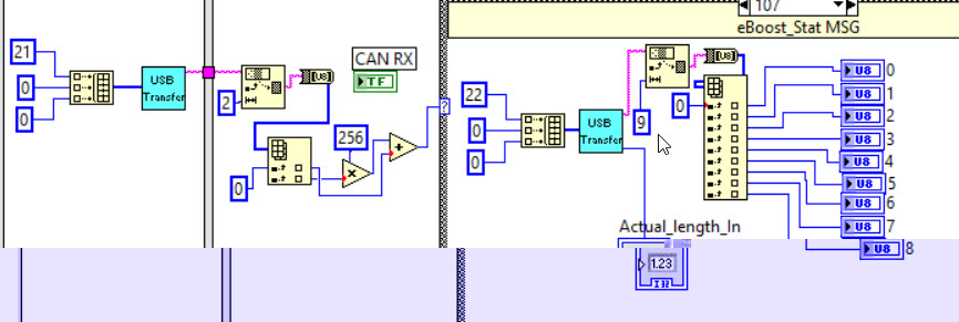

As described above with the problem of setting the CAN Data buffer it also seams to have an issue of reading the CAN receive buffer.
I send the Command to check of incoming messages which works fine ( see LabVIEW print screen) Th ID is returend correctly then I select with a case structure based on the ID what to do ,I then send the Command to et the RX Buffer Data it returns 9 bytes however the data bytes are always empty (0)
Please help with this CAN issues all other things are working PWM,ADC;Relay Switching and LCD

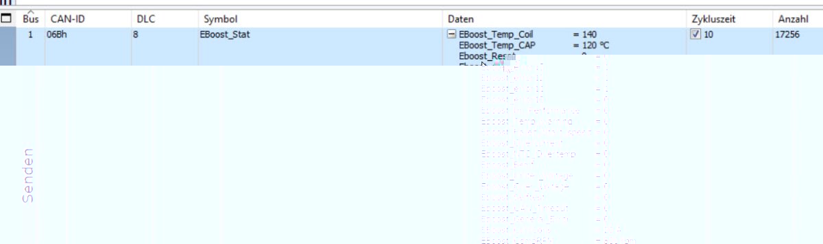

I can clearly and 100% say that there is CAN Communication with the real DATA as I am sending the correct ID and Data for the message from my PeakCAN interface with a CAN.DBC file from the Manufacturer of the machine
CAN Data Send from Peak-.dbc File with data
Capturing the ID and masking out what message was received
Correct number of bytes is returned but no Data :D

Thank you very much for your efforts however this is exactly the point the MIAC is advertised with labVIEW support however there is issue
with it ,let me try your files and look a bit deeper however at the end of the day together we need to solve the labVIEW issue :D

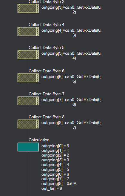

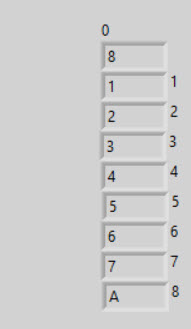

I commented the CAN buffer read in the FC firmware and load the outgoing string with the length of 9 and numbers from 1-7 and 0x0A in the 8 th byte posision the data should look like this in the array byte 0 the length and then the numbers following in each element which is then send over the USB and received perfectly in LabVIEW see print screens.
In my humble opinion there is some error /logic error in the firmware when the command 21 is issued the firmware returns the ID correctly of the message recieved then the firmware expects the command to get the received message Data(bytes 0 -7) which it does but it looks like it reads the wrong Receive buffer as the data returned is always 0
I can not say what the error is however the error is in the Miac FC firmware
Here the array is received correctly by LabVIEW as pre-loaded in the Firmware
