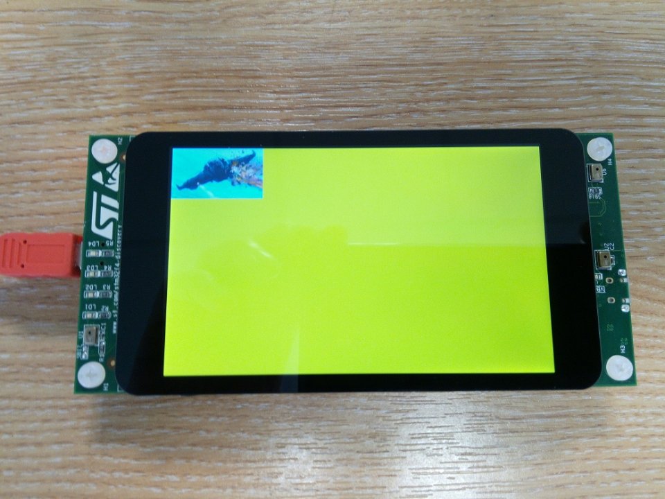

The demo looks like this ...
As Ben mentioned, when loading or running the project in Flowcode you might get popups,
if you get one like this, click No ...

yes Benj you were right about 24 bit pictures, it is runing and also there is pop up error like LeighM said . But program works.
Did you try to set bacground color? It is always same.
Re: STM32F469 DISCO
To change the background colour try changing the colour and then call the clear function. This should redraw the entire background in the new colour.
